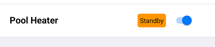

If I understand correctly, there’s two potential solutions here for acquiring heater ON with standby status true or false:
  1. Leveraging developer tool states for heater standby.
  2. Using a python script.
So for option #1, I only was able to find this in HA developer tool states:
Not sure if the purpose of states is just to force a state vs. actually pulling the current state of an entity…
But the value ‘false’ is incorrect when you look at the iAquaLink actual status:
When the Jandy Zodiac heater actually turns on it changes from standby to heating in iAquaLink app:
Struggling on how do I get that state to report accurately for use as a automation trigger…
Anyone have any suggestions to get HA the ability to differentiate between on (standby) vs. On (heating) ?
