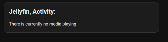

I have thrown something together (this is very rough), using Variables and a markdown card, but I can produce:
and it will dynamically update when items start and stop.

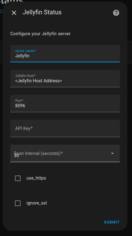

has ssl support:

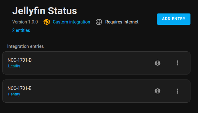

Can handle multiple servers (I have not had a chance to try this bit out)

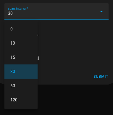

Scanning interval is adjustable, can be set to 0 (disable) so you can refresh it manually with in automation when a webhook call come in. This stops it polling all the time.

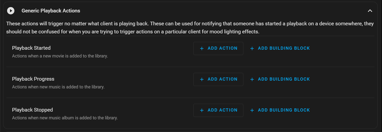

Have updated the blueprint to v2.4.20, this allows any playback started/progress/stopped event from a jellyfin webhook to trigger an action:
This will help with the integration when polling time is set to 0 (disabled) then it can be triggered by calling: jellyfin_status.refresh
This saves the amount of calls being made to the Jellyfin API for updates.

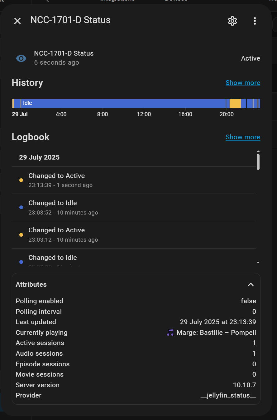

@oldbaldg I think I have tested as much of this as I can on this.
It produces two additional sensors, total and error. Total is the total amount of servers being monitored and an error sensor (the number of servers unreachable). These sensors attach themselves on to any generated entities… if you have multiple servers that you are monitoring then it can land on any of them, not an issue as the sensors carry the same id. You will see one with 3 sensors.
When configuring a server you can set a polling frequency time, or set to 0 to disable polling.
if disabled then use the generic playback actions for playback started and playback stopped to setup automations to refresh the sensor. The pro about this is that polling the Jellyfin API is kept to a minimum, con server going offline may not be registered as being offline. Could be a happy medium and set the scan to be every 2 minutes and use the webhook to trigger a refresh?

I have updated the blueprint to v.2.5.0
This introduces time constraints for when the actions should run.
This was requested on my Plex webhook blueprint, I thought I would bring it over to the jellyfin blueprint as well.
It can programmed up for Movies, TV Shows and Music:
I hope someone finds it useful
