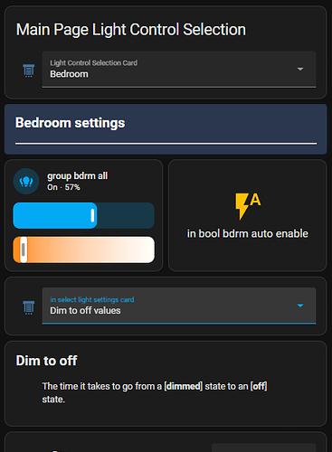

I’ve been working on a light blueprint to more readily integrate with other blueprints (via using timers in between on and dimming states) and to configure the values of it on the dashboard via helpers. (see dashboard pics below). I’ve also added a fancy feature where it will keep the lights of a group to the scene they’re set to and also save that scene to a temporary scene so that it can return to it. I also wanted this to be fully inclusive without anything from the HACS so that anyone could pick this up and use it as well!

example card pics:
room example with light settings:
room example with on to dim settings (timers not active due to manually turning on light):
room example with dim to off settings (timers not active due to manually turning on light):
