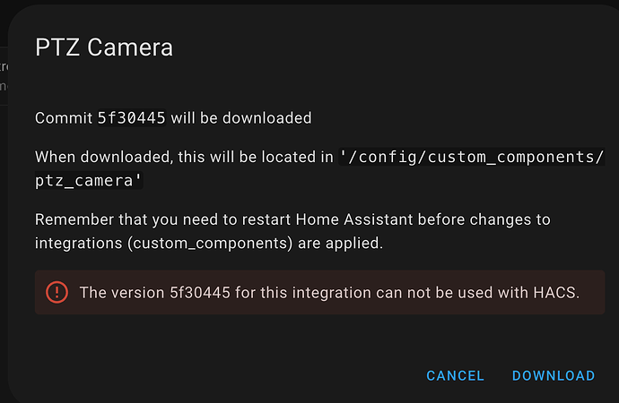

I am not able to install this, I am getting
Integration version: 2.0.5
Frontend version: 20250128065759
Anyway around this?

Same here, I cannot install it
Just to confirm that this thingy is still working :blush: Just installation through HACS is broken, but after manually installing it, and little fiddling, I spared me from using heavy artillery (Frigate).
