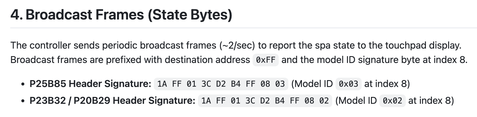

@tprommi This is very interesting behavior! Until now, the assumption has been that byte 8 in the broadcast signature depends on the controller model:
(See section 4 in protocol reference)
If you have a P23B32 which broadcasts 0x03 we might need to revisit this.
Is the alexbde/ha-joyonway integration working for you? Which board version do you have if you go to your spa touchpad > Menu > Set > About > scroll one up (or all the way down)? Mine is:
Hi @tprommi, great find, and thanks for digging into this.
On my side the broadcast signature ends in 0x02 and has been stable in production for weeks on a P23B32. But per @alexbde's protocol reference (section 4), byte 8 is the Model ID: 0x02 for P23B32 / P20B29, 0x03 for P25B85.
So your controller broadcasting 0x03 is most likely identifying as a P25B85, not a P23B32. That explains why my 0x02 signature never matched, and why forcing 0x03 suddenly worked, you're reading a P25B85 broadcast.
Worth knowing: water temp and setpoint decoded fine because those byte positions line up, but the rest of the map differs between models (panel command prefix, pump and heater masks). Decoding a P25B85 frame with my P23B32 map can give wrong states on the other channels. For a P25B85 you'd want the matching adapter, and @alexbde's integration already has a modular adapter targeting it, likely the cleaner path for your hardware.

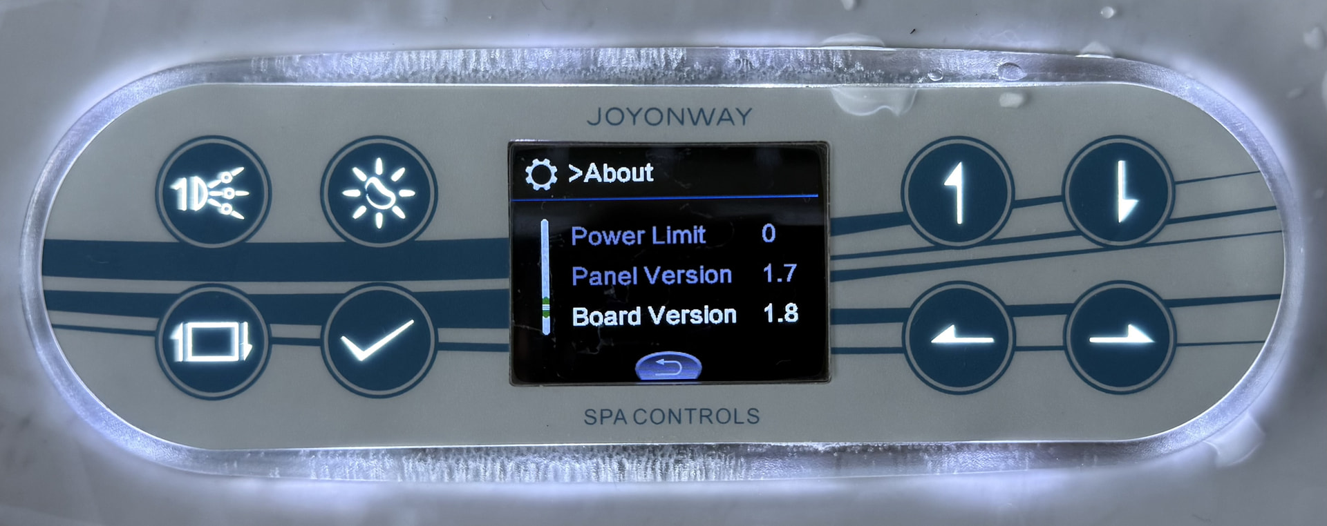

Could you confirm your exact model on the touchpad? Menu > Set > About, then scroll all the way up (or down). If it says P25B85, that settles it. If it really reads P23B32 while broadcasting 0x03, then we have a genuine hardware oddity worth digging into.
Sorry, that was a mistake on my part. I opened the pool again and found that I have a P25B37-2032. My apologies. I now have the HACS from alexbdb. Most things work right out of the box. Great job!
Panel Version 1.8
Board Version 1.8

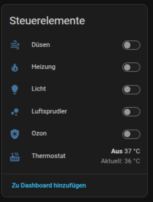

There are a few issues, though.
  • sensor.joyonway_p25b85_dusen is correct. It detects levels 1 and 2 of the pump. fan.joyonway_p25b85_dusen is a toggle button; it switches between Off and (Level 1/2). But I can’t control anything with it. Im missing Jet Controle.
  • I can change the lighting color on the display. Off and On are displayed correctly in switch.joyonway_p25b85_light. Every time I turn the light on and off, it changes to the next color.
  • joyonway_p25b85_clock_auto_sync does nothing.
  • sensor.joyonway_p25b85_status is always unknown.
  • I don’t know if the dashboard generates automatically.
    switch.joyonway_p25b85_air_diffuser is not configured for my pool.

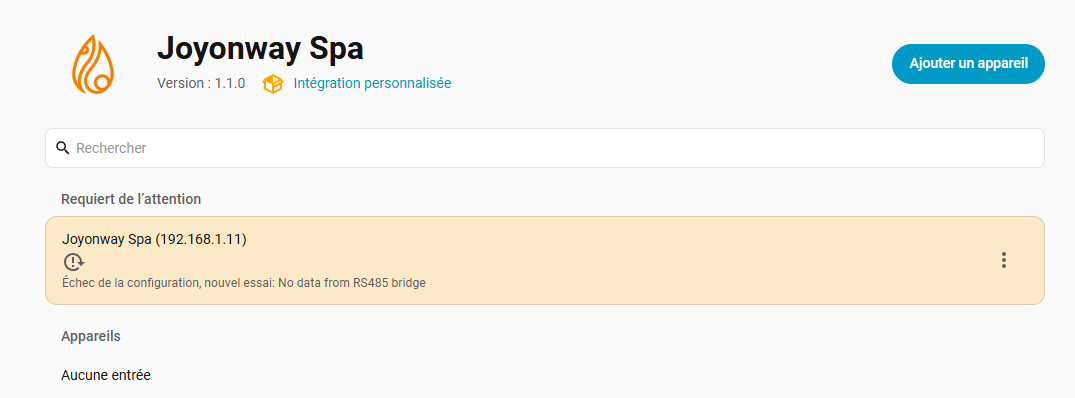

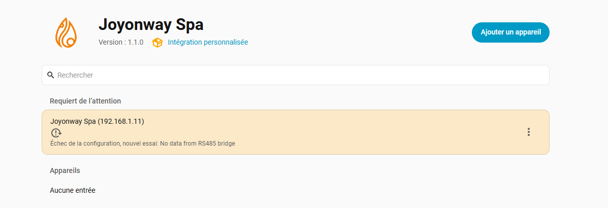

:frowning: I have the same message, I can share with you my script that allows me to control my entire spa system, if that can help.

Thanks for the updates, this is extremely valuable for mapping the controller family models!
@tprommi (P25B37)
It is great news that the P25B37 broadcasts using the 0x03 signature byte and that all standard status readings (temperature, setpoint, light status, and pump levels) decode correctly using the P25B85 mapping out of the box.

@Yannickt26 (P20B29)
Regarding the ZLAN5143D — thanks for sharing! It's a great reference for a reliable Ethernet-to-RS485 bridge.
I noticed in your Post #109 capture that your P20B29 actually broadcasts 0x01 at index 8 (1a ff 01 3c d2 b4 ff 08 01...), whereas the P23B32 uses 0x02 and the P25B85/P25B37 use 0x03. This explains why the config flow's auto-detection failed on your setup (as it was only looking for 0x02 and 0x03).
You mentioned you have a working script that successfully controls your entire spa system. Please share your script here! Comparing your working command frames side-by-side with our P23/P25 adapters will help us add full support for the P20B29 model in the integration.
I’ve carried out a few more tests and described the situation again in more detail. The guided capture was also performed: Light and Jet control of P25B37 · Issue #57 · alexbde/ha-joyonway · GitHub

Hi @Yannickt26,
thanks for testing! Since the config flow successfully auto-detected your spa model as a P20B29, this means that the TCP connection works and HA is seeing a valid data stream from your RS485 bridge. There are no issues with the wiring, baudrate, or data formatting (we would have seen a different error then).
The No data from RS485 bridge error only happens afterwards when the integration tries to establish its persistent connection. My best guess is that your custom script is still running in the background and holding the TCP connection, creating contention with HA.
To resolve this, you could:
  • Option 1 (Deactivate the script): Stop your custom Python MQTT script completely, and then reload the integration in HA. This is the simplest way and should prevent command collision/bus contention.
  • Option 2 (Configure multiple TCP connections on the bridge): According to a quick research (AI :waving_hand:), your ZLAN5143D hardware should be capable of supporting multiple simultaneous TCP connections. If your bridge is currently rejecting or dropping the second connection, its settings might be configured to limit concurrent sessions to 1 or something like that. Could you take a look if you can configure it to allow multiple parallel connections? This will allow both the integration and your script to connect at the same time.
My script was desactived when I tried yours.

During testing, Home Assistant was receiving valid Joyonway frames, but the P20B29 adapter was not parsing them. The broadcast frames from my controller start with:
1A FF 01 3C D2 B4 FF 06 01
In the current P20 adapter, the expected signature was:
1A FF 01 3C D2 B4 FF 08 01
So I changed the P20B29 signature from:
P20B29_SIGNATURE = bytes([0x1A, 0xFF, 0x01, 0x3C, 0xD2, 0xB4, 0xFF, 0x08, 0x01])
to:
P20B29_SIGNATURE = bytes([0x1A, 0xFF, 0x01, 0x3C, 0xD2, 0xB4, 0xFF, 0x06, 0x01])
After this change, the integration started parsing the status correctly and all main entities appeared in Home Assistant.

Hello guys,
Sorry for my bad English. I have a problem with a Joyonway P25B85 (PCB) P2325B0003 R06, "P25B85-2022". I need to integrate this in Home Assistant with GitHub - alexbde/ha-joyonway: Home Assistant custom integration for Joyonway spas · GitHub.
However, I don't have a PB554 control panel; I only have a PB557. The CN24 and CN23 contacts are both unused. I can measure 1.4V between A and GND, and 1.8V between B and GND. So, it appears to be wired on the circuit board, yet I’m not receiving any data. My PB554 control panel is connected to CN25, which only has three contacts connected. Now, my question is: is the missing PB554 control panel the reason why communication isn't taking place? What can I do? Can I retrofit a PB554 and get it working? Or are there other options? There doesn't seem to be any usable data coming from CN25.
Thanks in advance, Andreas.
