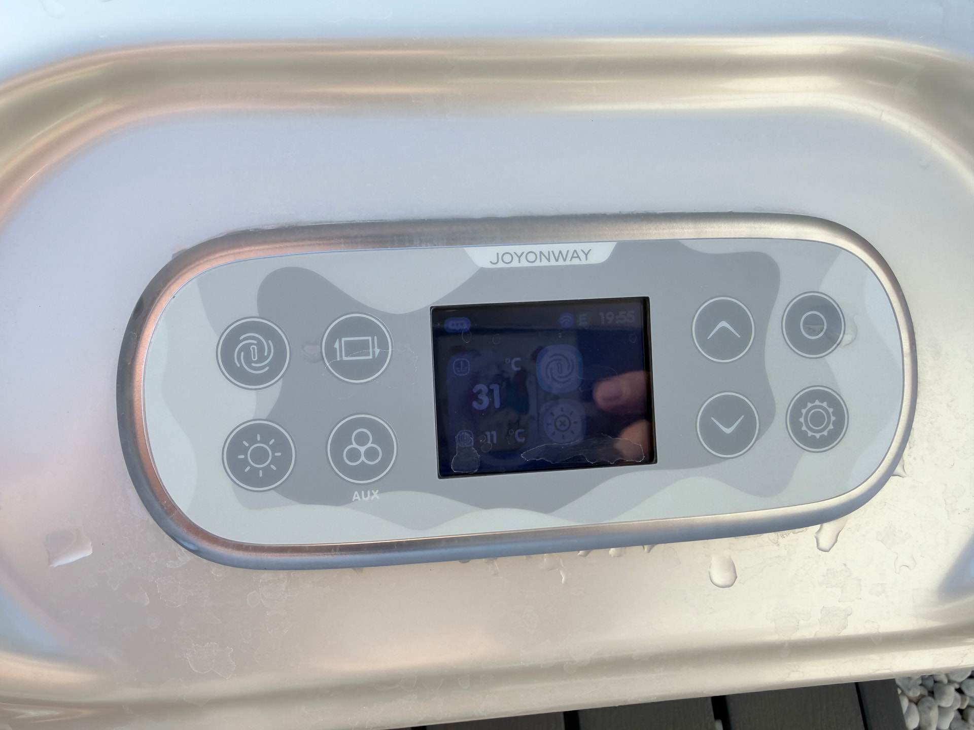

I’d like to add my spa to the list of supported models: I own a JoyOnWay P68B123, sold in Italy under a different (rebranded) name by a local reseller. Attaching a few photos from the reseller’s listing below.
I tried to build a custom component myself following the same approach used for this integration (Alibaba Cloud IoT backend, iotToken, HmacSHA1-signed requests), but I got stuck on the X-Ca-Secret used to sign requests to the gateway — I could see the X-Ca-Key and the iotToken in the traffic capture, but not a usable signing secret (I found some candidate strings in the APK’s dex, like P3VARMboTE52sCoT, appearing near the spa’s nickname P23B23, but couldn’t confirm which one is the actual secret or how it’s derived).
Does anyone (especially @Gaet78) think it would be feasible to extend the existing component to support this model, or has anyone already solved the signing-secret issue for a similar SKU? Happy to share full traffic logs / APK strings if useful.
