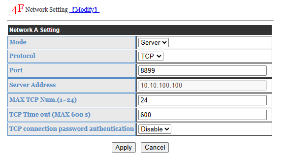

I’m receiving data with the USR-TCP232 tester. Is there another way I can test whether the data is being received correctly?
How is your Home Assistant installed — HA OS, Docker, or Core?
I could email the W610 settings and a recording using USR-TCP if needed.
How can I see what data HA is receiving?

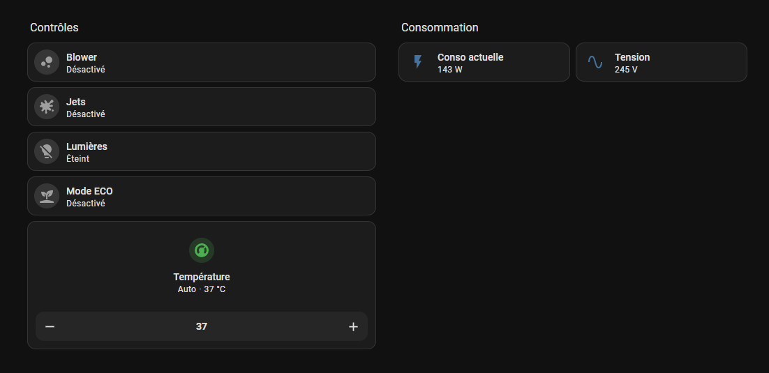

for people who have wifi controller, don’t use Joyonway or Jow SPA apps, just use tuya.
Add the device to your tuya account and then use Tuya Local for Home Assistant.
Create a custom device, because tuya local failed to collect DPs.
products:
  - id: jbxvi3pbxjjlmec2 # change with the id found by Tya Local
entities:
  - entity: climate
    dps:
      - id: 3
        type: integer
        min: 15
        max: 40
        step: 1
        scale: 0.1
      - id: 24
        type: integer
  - entity: sensor
    class: power
    dps:
      - id: 102
        type: integer
        unit: W
        state_class: measurement
  - entity: sensor
    class: voltage
    dps:
      - id: 101
        type: integer
        unit: V
  - entity: switch
    dps:
      - id: 104
        type: boolean
  - entity: switch
    dps:
      - id: 125
        type: boolean
  - entity: switch
    dps:
      - id: 117
        type: string
        mapping:
          - dps_val: "normal"
            value: false
          - dps_val: "strong"
            value: true
  - entity: light
    dps:
      - id: 123
        type: boolean

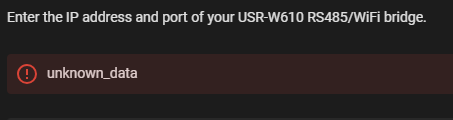

Fingers crossed the protocol isn’t different depending on the controller! Mine is a P69B133. During the integration setup, I now check whether the received frames match the expected format. In v1.3.1 I added a specific error message when data is received but not recognized as valid Joyonway frames. At least that way we can confirm HA is getting the data, even if the integration can’t parse it yet.

Hello, Thanks for this topic who is very interesting, I have P20B29 with Wifi Module, I bought the w610 and with your last update, I have read the value of my spa. If I am in 115200 i Have this answer :W610 192.168.1.11:8899 — received 3063 bytes but no valid Joyonway frame found. First 64 bytes: e0 7e c0 e0 80 e0 1c 00 00 00 fc 00 1c e0 fe 00 00 00 00 00 00 00 e0 8e fc 7e c0 fc 80 e0 1c 00 1c 00 e0 7e c0 fc 80 e0 1c 00 00 00 fc 00 1c e0 fe 00 00 00 00 00 00 00 00 00 1c 0e ff 00 e0 fc
And If I am in 9600; I have this answer W610 192.168.1.11:8899 — received 421 bytes but no valid Joyonway frame found. First 64 bytes: 64 4b 80 51 a2 65 4b 90 40 aa 66 4b 90 a0 aa 35 43 02 02 7f f9 28 20 02 cb fe 67 04 02 83 ff 66 20 02 ac fe 67 20 02 83 fe 66 20 02 03 fe 64 20 02 27 fe 67 7d 88 11 0e 02 24 de 80 c3 a6 6f f8
Do you know how to do or what I need to change for having my spa recognized by your integration?

I am currently setting up a USR-W610 bridge on the RS485 bus to use your HACS integration.
