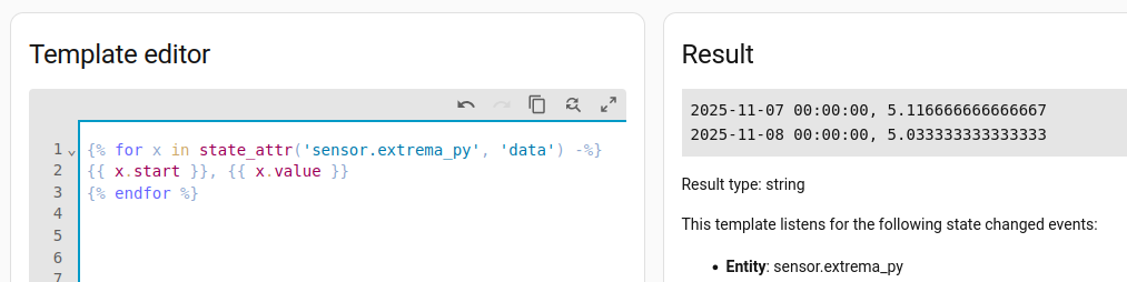

Try the following example. I tested it on my system and it reported the state and the data (as an attribute).

    json_attributes:
      - data

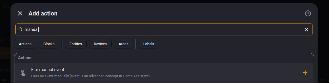

Yes, by firing a custom event, as I linked previously...
ACTION:
And adding an Event trigger for that custom event to the configuration of the template sensor.
ahh.. sorry! I did not understand it and really didn't understand a custom event was a manual event! I am embarrassed to say how many times I have searched and not found any docs and thought I will figure it out later .. today seems to be later. thank you very much!
any idea why the names are not the same or why "fire manual event" is not found in the docs? I would humbly request that it just says in that section "This can be done in the GUI via 'fire manual event'" (if someone should see this that can modify this as it seems I can not suggest it myself via github?)
With this insight I think I am getting it - I guess I would trigger an event with "fire manual event" i think something like this:
