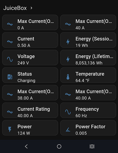

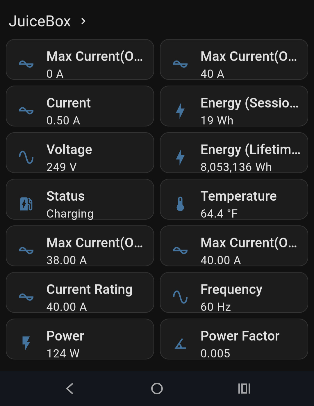

Deleted everything and started over. When i change the online max it shows the change registers, but charger does not react.
Set to zero amps, but still drawing power.

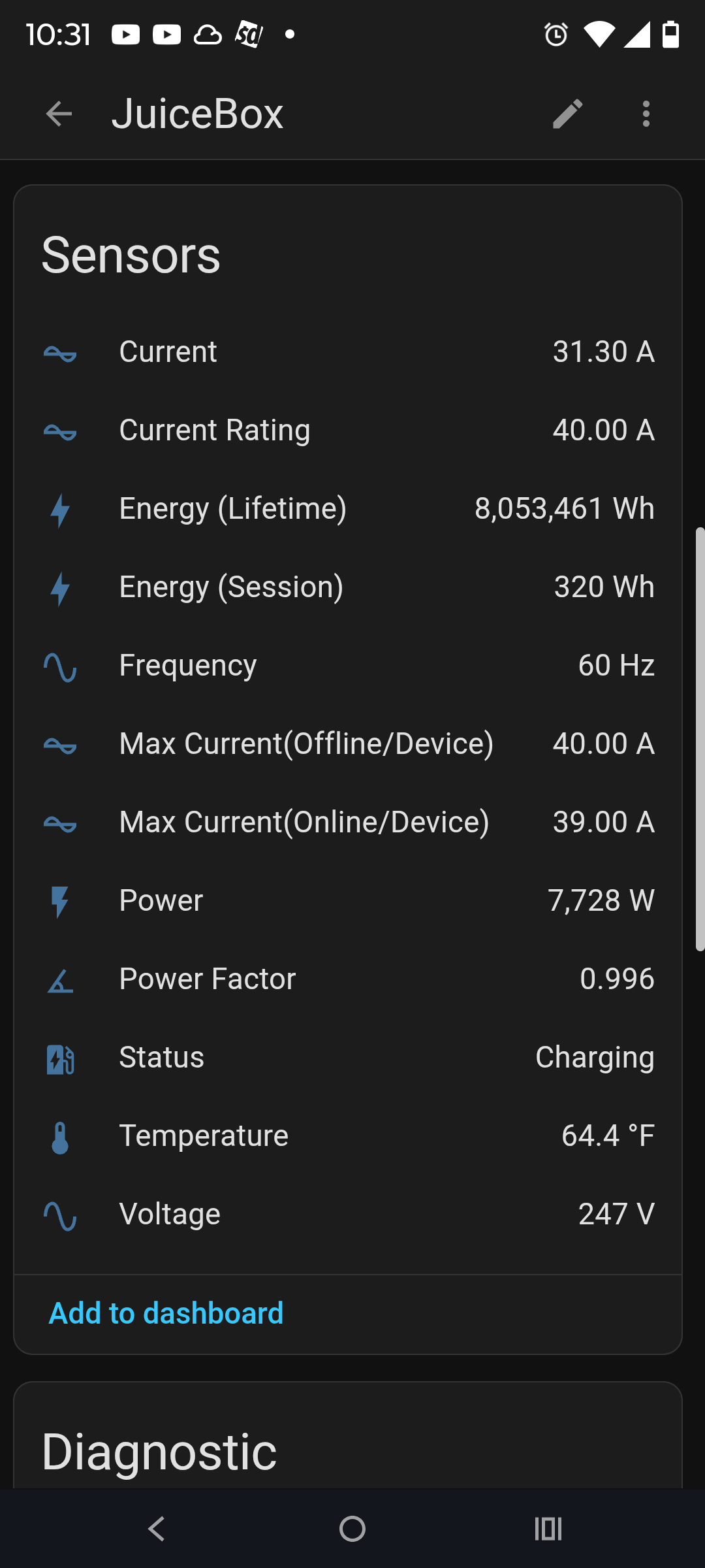

Set to 0A, but putting out 32.30A several minutes after action ran.

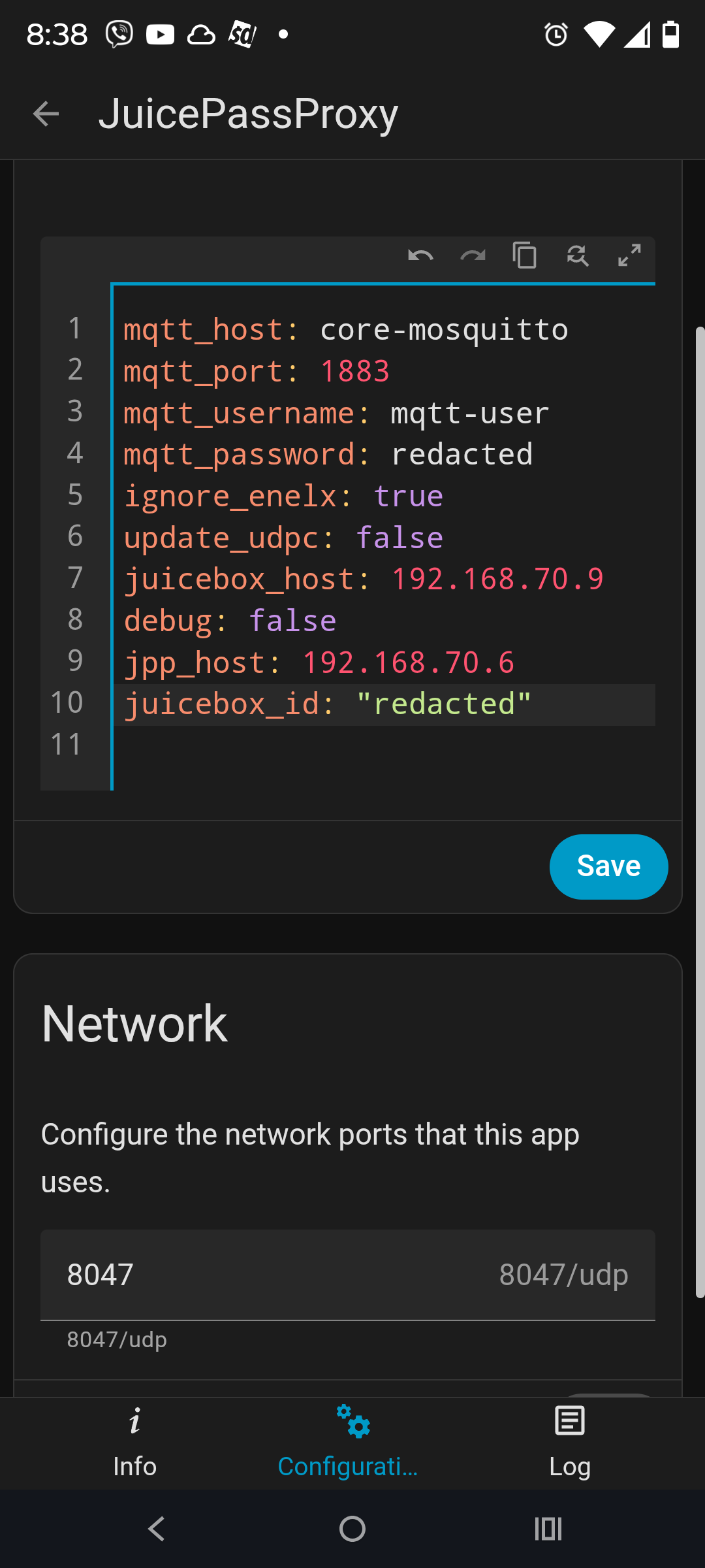

Also can you please post a screenshot of your configuration page for the add-on?

Everything in your logs and config look correct to me, so I’m really not sure why this isn’t working ![]()
