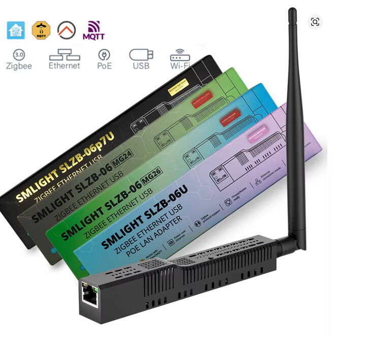

Tip: remote Zigbee coordinator over LAN / WiFi
A USB Zigbee dongle plugged into your HA server works fine, but coverage depends on where your server is located — not always where you need it. Using a USB extension cable helps reduce interference, but doesn’t solve distance.
A LAN-connected Zigbee coordinator is a great alternative: place it anywhere on your network, right next to your Zigbee devices, for a much stronger and more reliable signal. Can also be connected wireless over WiFI.

  • Save yourself the headache of dealing with USB and get a LAN/PoE coordinator like the SMLight mentioned above. Sure, it’ll cost more than a USB coordinator, but you won’t have to deal with USB interference, device paths & suboptimal positioning.
