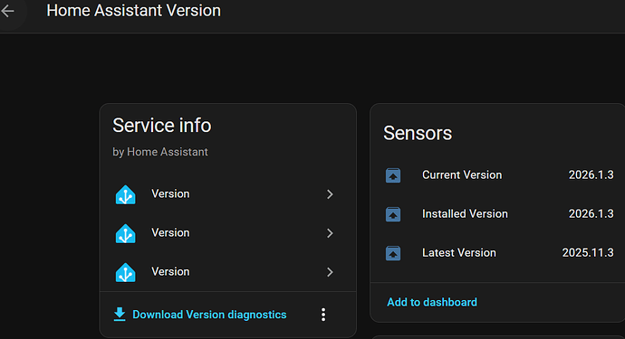

Just me or actual issue? Latest version stuck
With the integration version you get these entities.
But by some reason one is stuck at 2025.11.3
It’s Just You, who don’t provide relevant info :wink: , which “Version” integration did you choose to install ? , there are 5 Options to choose from, and most only provides 1 entry, (And which HA install are you running), there are Multiple
I don’t know.
Back in the days of yaml configuration there was sufficient information in the yaml to answer the questions. Now all I can see is what I have posted here.
I have no clue what I selected, if I even did that, it could be this was automatically migrated from the yaml config I had.

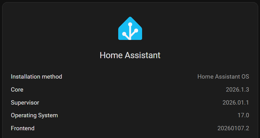

HA install is:

Found this in diagnostics:
            "state": {
              "entity_id": "sensor.latest_version_2",
              "state": "2025.11.3",
              "attributes": {
                "source": "supervisor",
                "channel": "stable",
                "audio": "2025.08.0",
                "board": "ova",
                "cli": "2026.01.0",
                "dns": "2025.08.0",
                "os": "17.0",
                "image": "raspberrypi4",
                "multicast": "2025.08.0",
                "observer": "2025.02.0",
                "supervisor": "2026.01.1",
                "friendly_name": "Latest Version"
              "last_changed": "2026-02-02T08:40:33.436463+00:00",
              "last_reported": "2026-02-02T08:40:33.436463+00:00",
              "last_updated": "2026-02-02T08:40:33.436463+00:00"
This integration provides the sensors; Home Assistant Supervisor - Home Assistant
It does indeed look peculiar , and with a trailing _2 ( seems like a duplicate hic-up )
Have your tried to uninstall and restart, and install again ?
As the pic only says “latest version” and Not “of what ?”, i would say it’s a bug
OR a fatal fu in a UX release :joy:

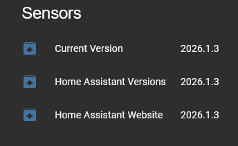

I would have expected a Version-Integration would show OS/Core/Supervisor/Etc …In Clear-text … This is what my HAOS shows, never heard the word “Home Assistant Website”
I assume 1st is Current, an 2nd is My Install , hmmmm or was it the other way around, Current is what i have 2nd is HA-Repos ver. :thinking:
WTF is “Home Assistant Website” ?
PS: i just picked the 3 first of the initial 5, can’t find anything “Latest” or , and again, it’s a totally useless Integration , if they can’t named them so one would know OS/Core/Supervisor/
