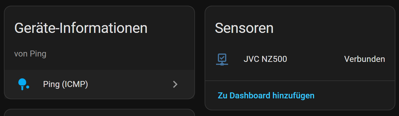

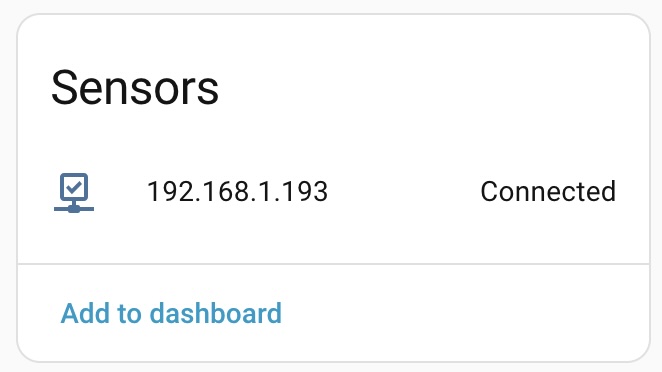

You got a ping response so the projector is connected to your network. That leads me to think the docker container running HASS doesn’t have a network path to your projector.
Try installing the Ping integration and see if you get a Connected sensor to your projector’s IP address. That should tell you if Home Assistant has a network path to your projector. Let me know what you find…
What the… As you advised, I added ping integration for both ip address and hostname, it was showing success as I thought and suspected it should, but after that also JVC integration started to work. Total mystery!
I was even trying before to ping pj from container itself, by attaching to it, ping from inside of container. It worked fine before. But not pj integration. Now all good.
But ping integration kinda blew hole from container to pj.
Huge thanks for idea!
Ha! That’s great. Glad it’s working!

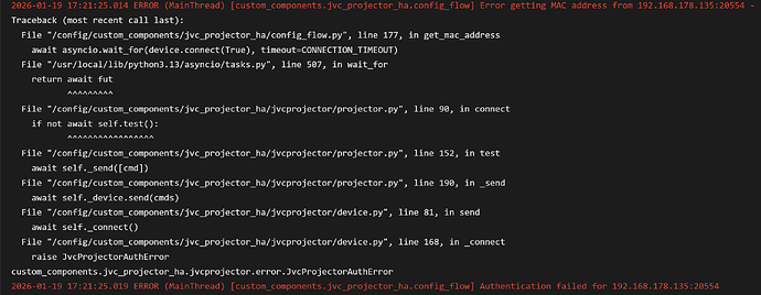

I’m having a similar problem with my NZ500 not connecting. The error message is “Authentication failed.” I tried the ping suggestion and found and added the IP address and hostname. Unfortunately, the error persists. I also created the password using a hash, as per the instructions.
Oh, the projector is connected to my switch via LAN.
Regards, Manu
Hi Manu,
That looks like a connection error not a password/auth error. Meaning the integration is trying to establish a connection to your projector and timing out. When you setup the ping sensor, did it show it as connected?

Hi Matt, thanks for the quick reply.
Yes, the connection was established via ping and is currently integrated as a device and is showing as connected. in German… :slight_smile:
Regards, Manu
Hmm, OK that rules out connectivity. The projector is rejecting the password. Are you sure you have the right password? I messed up generating the hash on my first try by leaving a trailing space after the JVCKWPJ
If you can enable debugging and send the raw logs that will give me more info to help troubleshoot.

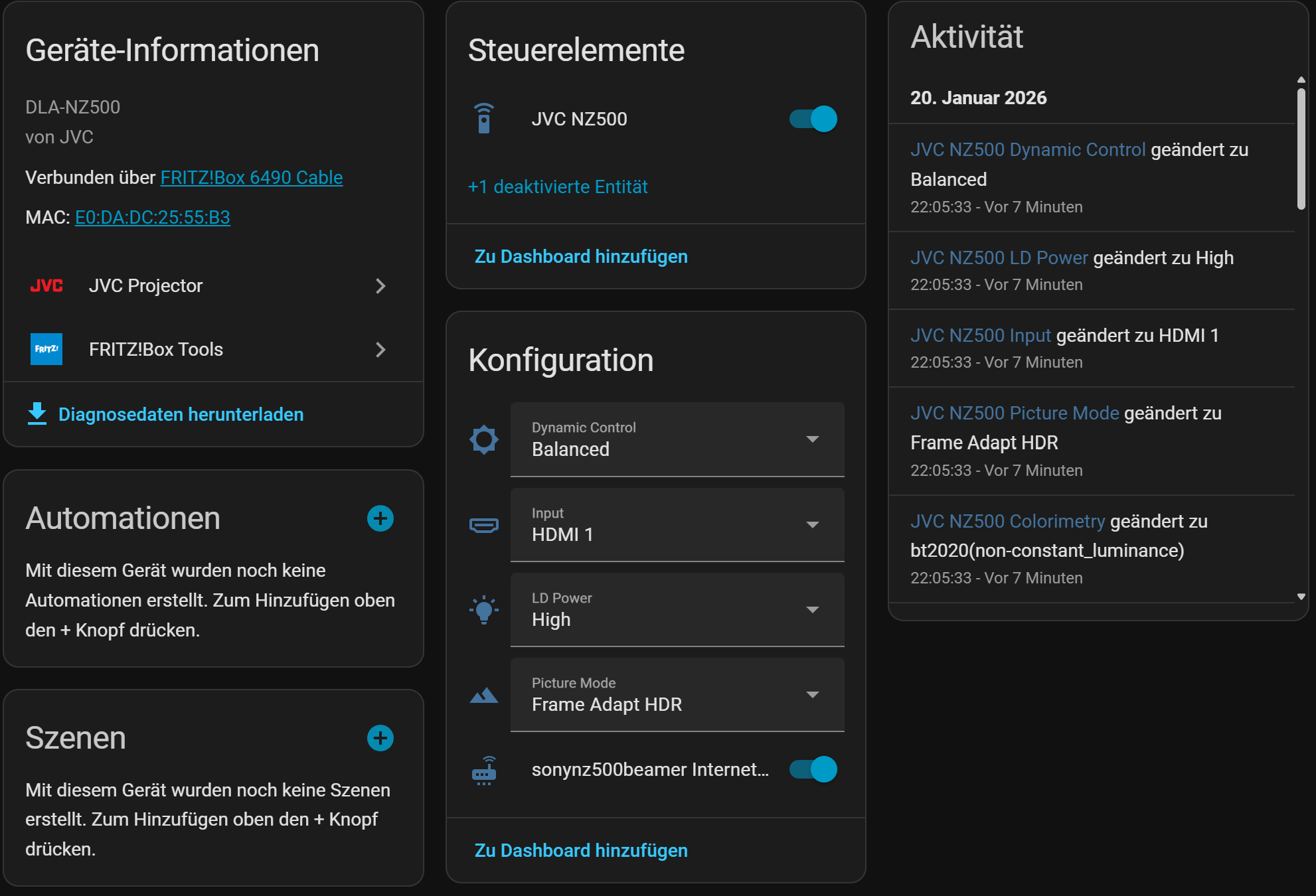

Hi Matt,
I’ve now removed the JVC from my router and tried everything again. I’ve also changed the password several times and tried again each time, but I keep getting the same error. I made sure there were no spaces in the password.
The ping also established a connection. I was also able to ping the JVC from a Windows PC.
Unfortunately, I can’t find a way to debug this because the integration hasn’t been completed yet. I’m also a newbie with Home Assistant and don’t know much about it yet.
:thinking:
Now things get weird… :sweat_smile:
I tried adding the projector using the built-in Home Assistant integration, with the password stored on the projector, and it worked. :thinking:
So I tried the same thing with your HACS integration, and… it worked! And without a hash password. :heart_eyes:
I was finally able to integrate and control the NZ500 as a device. I’m so glad it finally worked after countless attempts.
And you might also find it interesting that, at least for me, it only worked without a hash password.

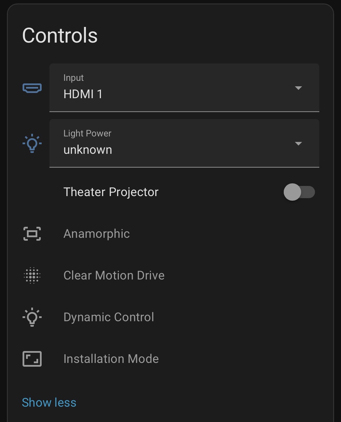

Hi @mjmcg and thank you for creating this integration! I have a NZ500 and so far the integration has been working well for me. I have three issues / questions that I would appreciate your insight on:
  1. When adding the projector via the integration, all of of the diagnostic entities besides “light time” are disabled by default, as are most of the controls (all except power state, light power, and input). Please see the attached screenshot. When I try to enable them all, it seems to break the integration: all statuses become “unknown” and control of the projector via the integration stops working. Why is that? Is there something I am doing wrong, or perhaps a bug in the integration? I am running the latest JVC firmware (1.02).
  2. I love that you added the ability to emulate remote commands. A command of particular interest to me is “hide” (aka “lens shutter”), which I would like to use in my automations as a means of putting the larger system into “standby” once turned on so that can I avoid having to wait for the long boot time of the NZ500 when starting an activity, without leaving the laser on (and consuming its finite life) when not needed. However, since the remote command merely toggles the hide state, I cannot reliably control it without knowing the present status of the hide state in the JVC. Do you know of any way to query the hide state, or some way to explicitly enable / disable hide, rather than just toggle it? I saw nothing like that in the JVC protocol docs.
  3. Adding to the complexity of using hide in automations: when hide is enabled, all other control actions I attempt with the NZ500 via the integration result in an error. This creates both a risk of breaking automations (due to unpredictable errors), as well as a potential opportunity to infer the hide state from the rejection of other control commands. Absent some other approach, do you think that it would be possible to modify the integration to infer hide state using this method?
Thank you!
