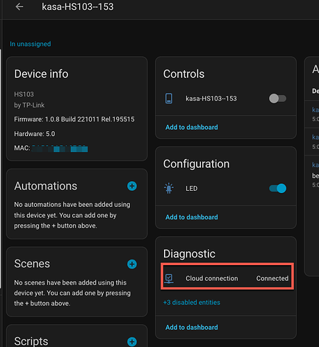

When using this, what does the ‘Device Info’ screen show?
if you mean the cloud connection, it says connected, but not sure how much that means, I have tplink blocked in adguard.
it still uses the tplink integration, so I would expect the device to have the same functions as with the cloud
either way, I don’t have or use any tplink authentication or app
