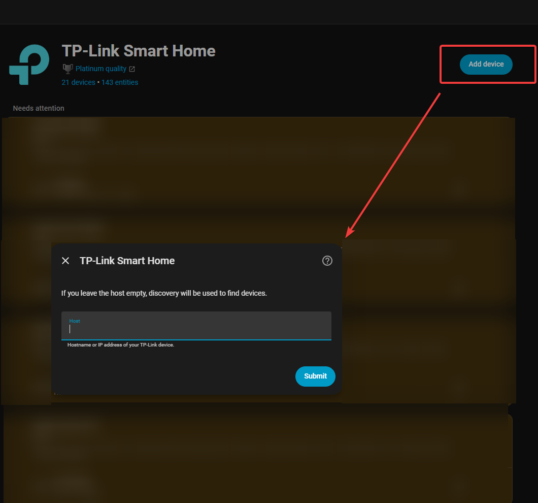

Just want to add that adding the device manually instead of discovery worked for me.
