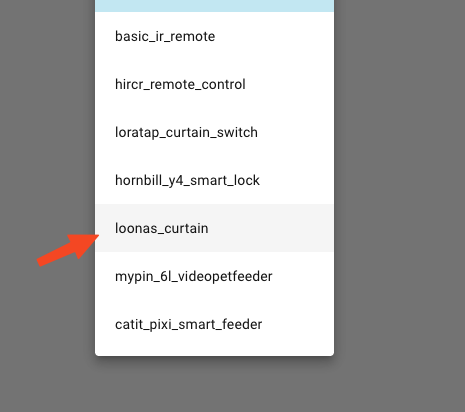

Integration into HA is more tricky. It shows in the official Tuya integration as unsupported. Initial attempts with Local Tuya also failed. In Tuya Local, I was able to see the devices and pick up their Device and Local IDs from my Smartlife login, then add the local IP. If I then set the version to 3.5, I get a list of possible devices, none of which are garage doors. Adding the device as an “Ioonas_curtain” allows a cover to be created that shows up as a curtain:
I can then change the device type to “Garage door” in HA and the up, down and stop controls work.
