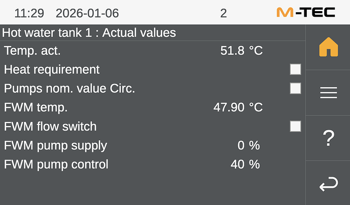

Just wonder if you looked into monitoring a FriWa (fresh water station) being controlled by the KEBA controller inside the WPS?
It’s in a sub part of the hot water section called fresh water.
I looked for Modbus variables within 20230912_MTec.Modbus_Server_VariableList V2.10.xlsm
but didn’t find a match?

I am glad that my integration works for you. Yes, you are right. Unfortunately, the Modbus registers do not provide FWM data.
But I can recommend you the Keba Keenergy Home Assistant Integration (GitHub - superbox-dev/keba_keenergy: A Home Assistant integration for heat pumps with a KEBA KeEnergy control system.).
With this integration, it is possible to monitor the FWM Temperature. You can also open an issue on the GitHub repository if you need more values. The developer is really responsive :slight_smile:
