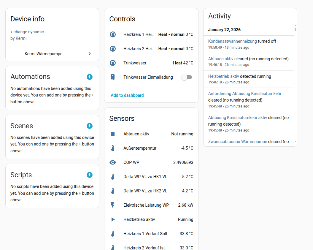

I’m working on a home energy management system and as part of that also need an integration of my Heim / Kermi heatpump. I’ve used Claude Code to reconstruct the API of the local web interface.
As there seems to be some interest, I’ve separated the Kermi bridge and published it here:
Please note, the bridge is successfully running on my system for some days but I haven’t tested the separated version. So there might be the need for minor debugging. Let me know if it works for you.

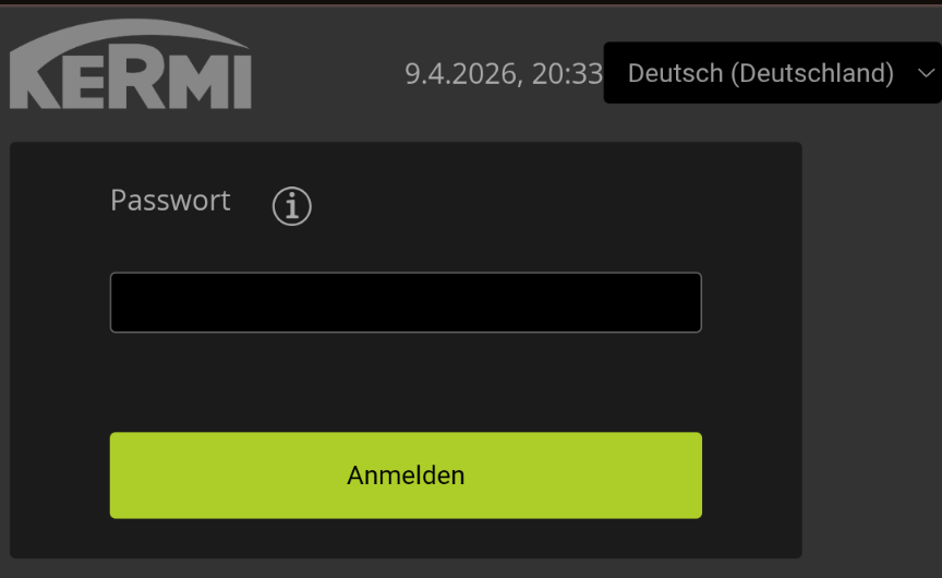

I haven’t seen an issue like that on my system. Also, I’m not aware I activated the web interface separately.

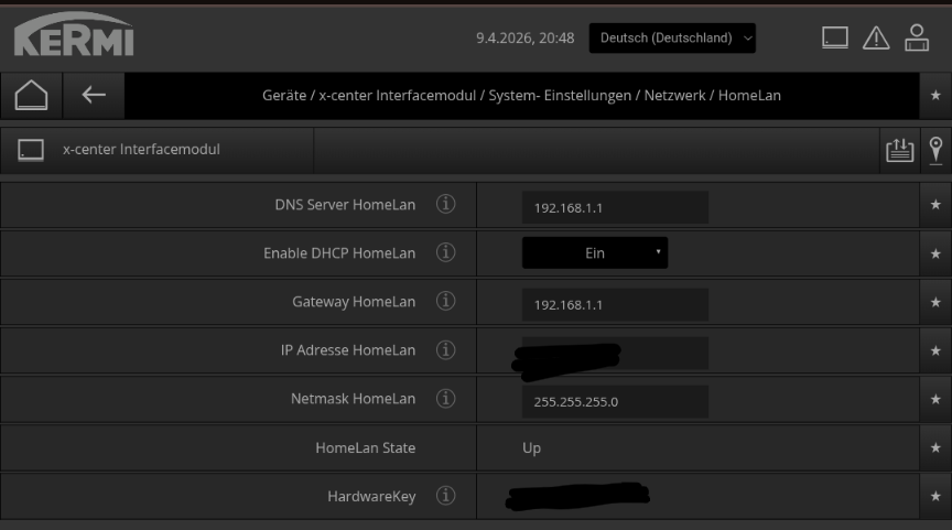

I see port 80 included in your IP. Did you specify that in the config file or was it just appended by the integration? In my case, I’m using the local IP without a specific port specified. Also, I’m able to reach the web interface over http (not HTTPS) with the IP and no port. You should see the following screen:
If that doesn’t help, another approach would be to try and set another password for local access in the xcenter interface module settings.
And verify the xcenter is on the same vlan as your home assistant server.
Edit: you might also want to double check your network/homelan settings. Mine look like this:
Hope that helps!

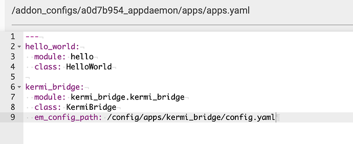

i have got a Kermi XCenter heatpump.
i tried to integrate the kermi-ha-bridge in the version v0.10.0.
I followed the instroductions on github, installed AppDeamon4.x, then downloaded the kermi-ha-bridge.
Is it right, that the path after downloading in hass is /config/appdaemon/apps/kermi-ha-bridge
because in the apps.yaml looks the path like this:
em_config_path: /config/appdaemon/apps/kermi_bridge/config.yaml
I tried a lot of things (rename the file-paths from kermi-ha-bridge to kermi_bridge) but nothing will work for me… :roll_eyes:
I put this
kermi_bridge:
module: kermi_bridge.kermi_bridge
class: KermiBridge
in the file
/root/addon_configs/a0d7b954_appdaemon/apps/apps.yaml

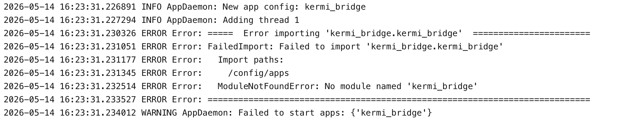

and this ist the result in AppDeamon-Log:
2026-05-06 16:41:36.577326 ERROR Error: =====  Error importing 'kermi_bridge.kermi_bridge'  =======================
2026-05-06 16:41:36.578601 ERROR Error: FailedImport: Failed to import ‘kermi_bridge.kermi_bridge’
2026-05-06 16:41:36.578995 ERROR Error: Import paths:
2026-05-06 16:41:36.579316 ERROR Error: /config/apps
2026-05-06 16:41:36.581736 ERROR Error: ModuleNotFoundError: No module named ‘kermi_bridge’
2026-05-06 16:41:36.583280 ERROR Error: ===========================================================================
2026-05-06 16:41:36.583963 WARNING AppDaemon: Failed to start apps: {‘kermi_bridge’}
Can anybody help me?!
thanks al lot
Hi @SirAssistant
apps.yaml is correct and usually should not need an edit. I assume, you copied the complete repo into the app folder, which will not work.
Please try only copying the sub-folder kermi_bridge into the appdaemon apps directory. This is where you found apps.yaml. Then only adjust the example config file inside kermi_bridge.
The documentation seems not to be fully clear and will be adapted.
Let me know if it works!

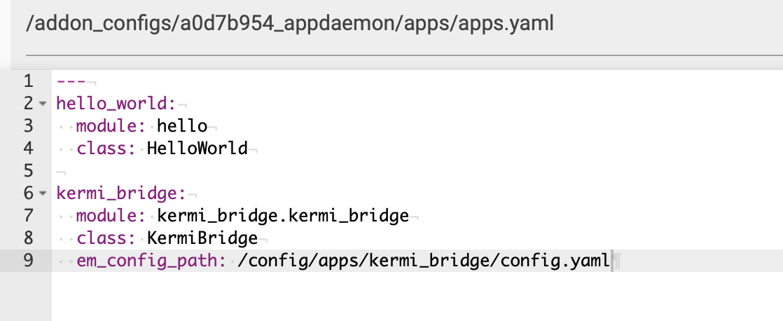

I copied the renamed folder (from kermi-ha-bridge to kermi_bridge) - there was no subfolder - to /root/addon_configs/a0d7b954_appdaemon/apps/
and with some try and error, i found out, that the right path in the apps.yaml was:
em_config_path: /config/apps/kermi_bridge/config.yaml
At last, with adding voluptuous to python packages in appdeamon, kermi_bridge was starting.
:grinning_face:

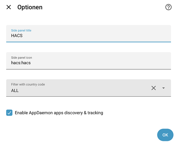

I installed the app-daemon add-on under "Settings"-->"Apps" and the added the custom repository in HACS with category app-daemon and installed the Kermi HA Bridge.
You should mention in the manual that you have to enable the App Daemon checkbox in the HACS settings before:

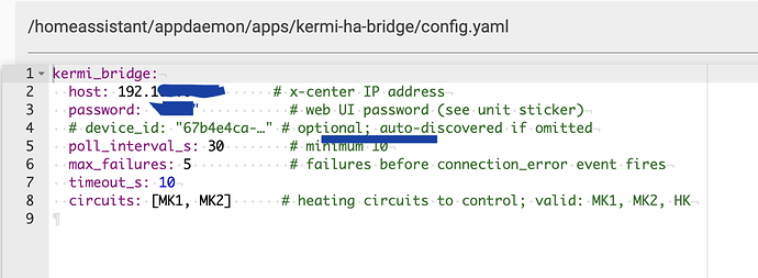

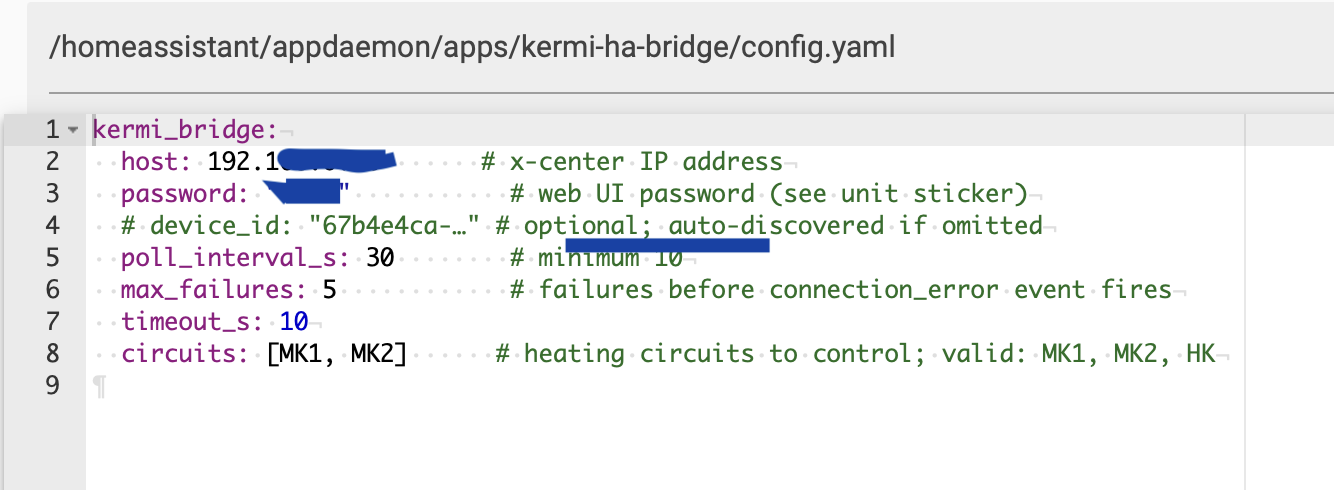

I added this to the apps.yaml in the folder /addon_configs/a0d7b954_appdaemon/apps/
the Kermi add-on is in this folder:
/homeassistant/appdaemon/apps/kermi-ha-bridge/
the config.yaml:
I get this error in the App-Daemon logs:
Can you please help
