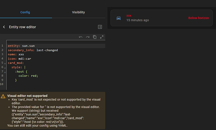

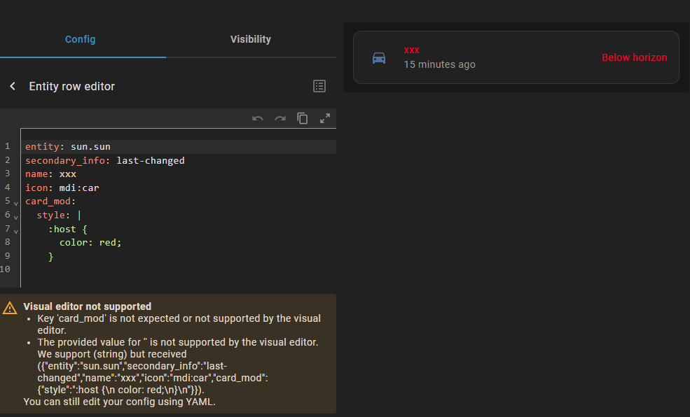

You probably mean Entities card.
The “visual editor not supported” warning is shown when you get to yaml editor for a particular entity row:
But it is not shown when you are editing a whole card:
In short - do not bother about that warning. Card-mod is a 3rd party plugin which may cause such glitches.
FYI: The style brush got lost when Frontend updated buttons during in 2025.8. 4.2.0 will bring back the style brush by upadting how card-mod finds the button to add the brush.
