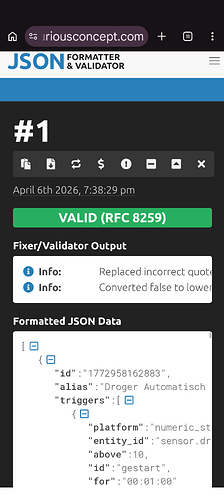

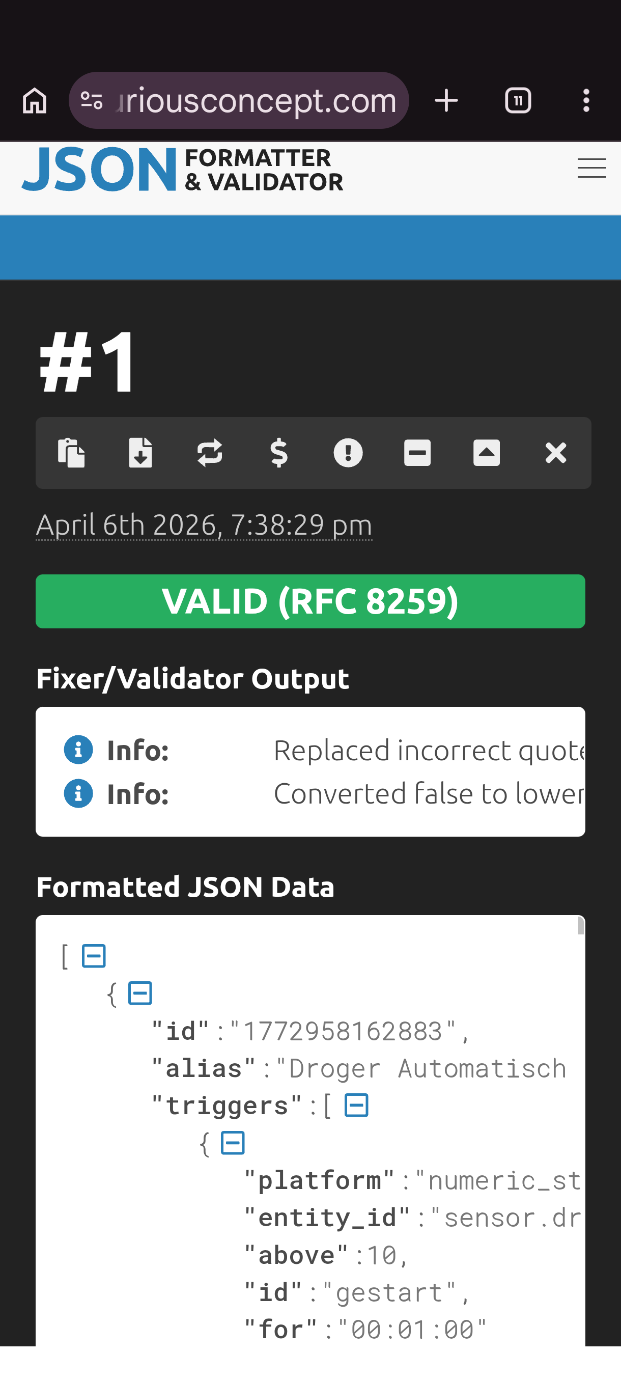

Running the json of the automation.yalm in a json validator gives this:
Right, the error though is showing code where it implicitly tries to get triggers from a dictionary. The key does not exist, so an exception is created.
So, what do I need to do, to resolve this exception?
