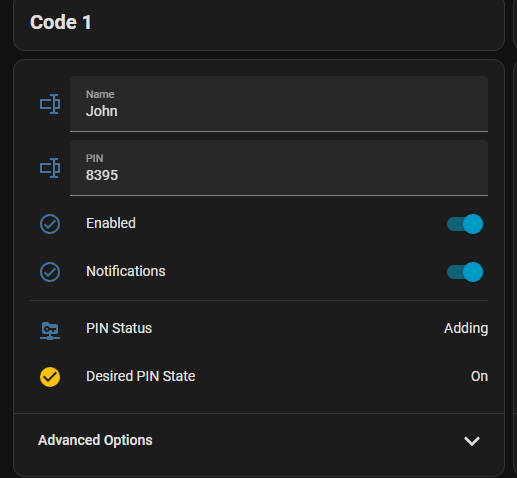

After a few upgrades, I went to put in a new door code into keymaster and noticed all my codes are in the Adding State. I’m unable to add new ones and no longer getting notifications. What happen? How do I fix.
It is not Keymaster per say, but Zwave addon/adapter. Restart the Zwave addon or do a cold restart(reboot) of HA.
Tried. Rebooted HA serveral times. Here’s a screen shot of my codes. As you can see it states “ADDING” this code has been there for over a year now.
I also rolled back to a version I thought was working 2025.8.1. I haven’t added or deleted new codes in awhile or I would have found this earlier.
Any suggestions on how I should fix this. I have 2 HAs in 2 different locations, Both doing the same thing. I really need to get this fixed as I have new employees starting soon and they need a code to get in.
If you’re on HA 2025.8+ and you’re still using Keymaster 0.0.99 that’s your problem You have to move to the beta branch if you want it working on current versions of HA. See ISSUE: HA 2025.8.0 breaks keymaster · Issue #454 · FutureTense/keymaster · GitHub
The next question you’re probably asking is, if the beta branch is the only version working since with HA 2025.8+ why hasn’t it been released as stable, and that’s because there’s a bunch of little issues that are still not working quiet right for folks and the work to figure out how to make 0.0.99 continue working on newer HA hasn’t been a priority to the maintainers. So you’re in a bind of either continuing to run HA 2025.7.x and using a fully functional Keymaster 0.0.99, or switching to Keymaster 0.1.0-b5 and dealing with the few issues it currently has.

In HACS you’re going to need find Keymaster and press the triple dot menu. Select Redownload and then expand the Need a different version? option and then in the releases select v0.1.0-b5.
After the install, restart HA. Wait until HA is fully up and then give it another restart just to be safe as the migration that the beta does isn’t always the cleanest and it might have issues.

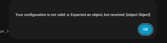

I copied the /homeassistant/custom_components/keymaster/lovelace.py page and pasted to bottom of my current Lock Dashboard, but it errors out
Not the custom_components/keymaster/lovelace.py file but custom_compoents/keymaster/lovelace/<lock>.yaml
Ok sorry, I don’t see this one. I only have these
Ok I found the file. I added it to the end of my current (old file)
/homeassistant/custom_components/keymaster/lovelace/garage_lock.yaml
Nothing shows on the screen below my old one.
If I remove the old and just have the new, when trying to save I get this error
So I created a new Dashboard and now it works. I deleted my old one. Now as for notifications… When an employee would use their code to unlock the door, I would get a notification from HA through Pushover. Will I have to change anything with that because I am not getting any notifications

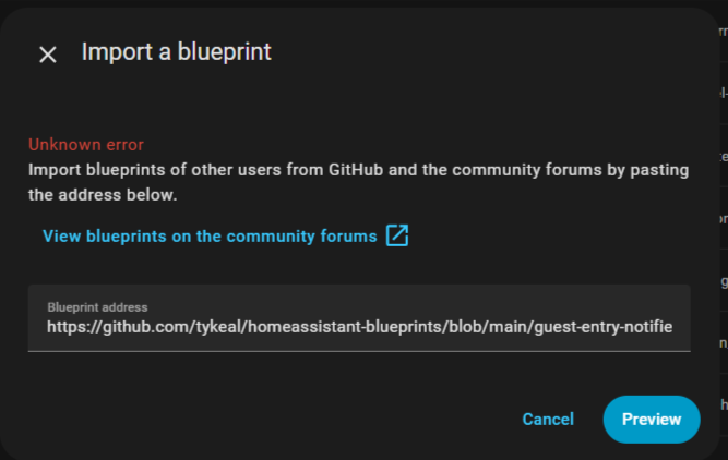

I tried to import the Guest Blueprint into HA but it’s give me an error. Maybe I don’t know what I’m doing… (Well I don’t) what URL am I suppose to use to import it?
