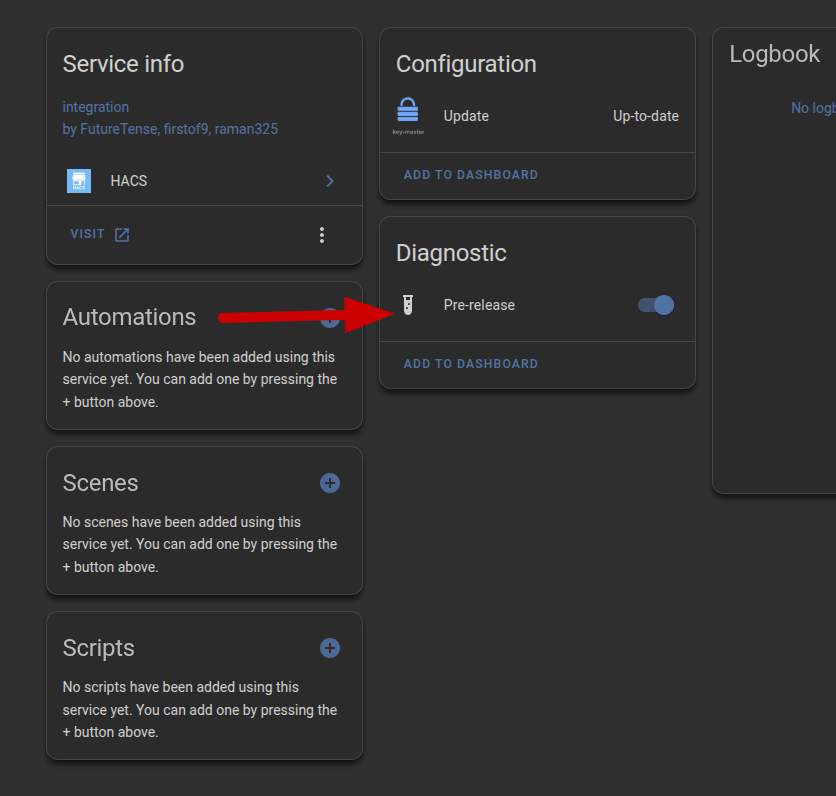

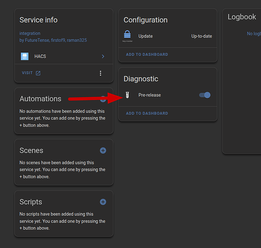

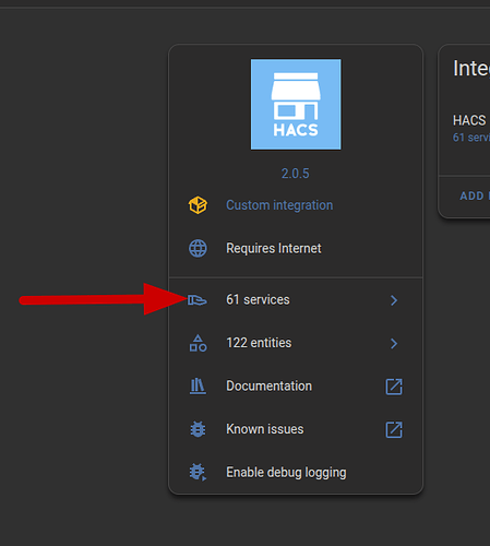

HACS changed how to get to betas, you have to turn it on via the HACS integration in Devices and Services.
Once you are in HACS from Devices and Services click here:
Find keymaster in the list and click it, once in there toggle on Pre-Release:
Then the beta will show up.
I’m seeing a beta a 0.99-b0 updated 8 months ago. Is this the recommended beta?

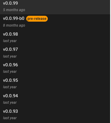

Considering that 0.0.99 is out, is there any reason to be on the b0 version?
If you don’t use Rental Control to drive locks for STR or other reasons then hopping on the beta will get you a cleaner configuration. I only say this because Rental Control relies on Keymaster to drive code automation for STR and I still haven’t gotten a version out that supports the updates made in the beta as it makes some significant changes to certain workflows that I haven’t exactly worked out yet cleanly.
I don’t use Rental Control. Cleaned up entities was my goal. The version numbering, and release date is what confused me as well as similar release notes. Makes it appear that 0.0.99 succeeds 0.0.99-b0, but it sounds like are ā€œimprovementsā€ in -b0?
Yes, definite improvements. All of the entities get attached to a device. All of the input_<type> entities are done away with instead there are corresponding <type> entities that are attached to the device. My experience while testing it is that it tends to be less likely to have an issue getting a code added or removed. Admittedly the testing on that was a lot less rigorous as I don’t have it in play anywhere currently as I need Keymaster for Rental Control

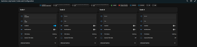

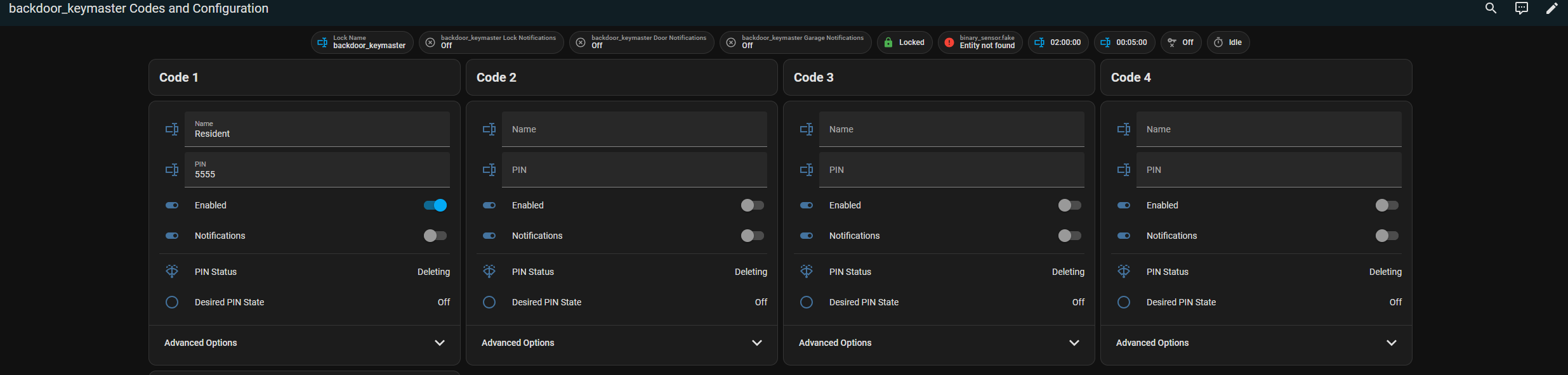

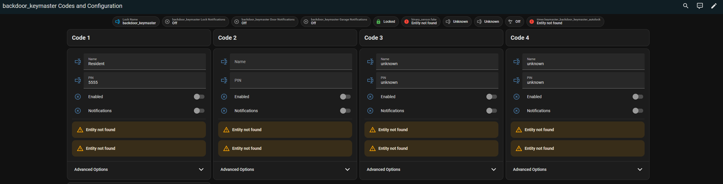

I tried looking through the form but couldn’t find anything on my issue. I believe I followed all the steps to setup keymaster correctly but I am getting ā€œEntity not foundā€ where I believe the ā€œpin statusā€ and " pin state" should be. I’m wondering if my locks are just not compatible? They are Schlage Connect Z-wave Plus
EDIT:
well I restarted Home Assistant and that fixed the first issue. Now I have a different issue where Pin Status is stuck deleting
