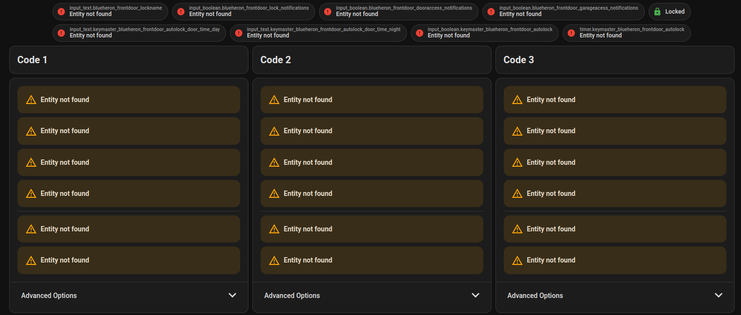

Applied beta and copied files, rebooted several times.
Getting this now.
Going to delete everything and rebuild using the beta version.
I am looking at several days of work now… :cry:
Please note that the beta has a different pre-built dashboard for you to put in place. It does not get generated in /config/packages/keymaster/<door> anymore but under /config/custom_packages/keymaster/??? I can’t remember where since I’m not currently using the beta. But if you’re trying to use the default built dashboard, you’ll need that instead as a lot of the entities get moved around with the beta.
