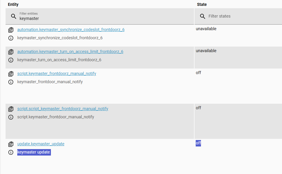

On the topic of the orphaned entities, when I added the ability to disable them I wasn’t able to find a clean way to clean-up the entities at the same time. So, yes, they are there, but you can easily remove them by going to your entities page and then filtering for Unavailable / Not provided. I would also recommend to add a filter for the Keymaster integration. Once you’ve done that you can enable the bulk select and select all entities and then bulk delete. All the entities that can be removed will be, you’ll still have some there after but those are expected as several of the entities are marked unavailable if certain conditions are not met.
Just did exactly as you suggested. For fun I looked around a little bit before I deleted anything. I had 2283 entities total (wow have I gone a little crazy with the home automation?!?!) of which 503 were “not provided”. Of those, I deleted 273 that were associated with keymaster (mostly the advanced stuff I disabled and don’t use). I did notice a handful of entities that were “automation” types, but not provided.

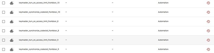

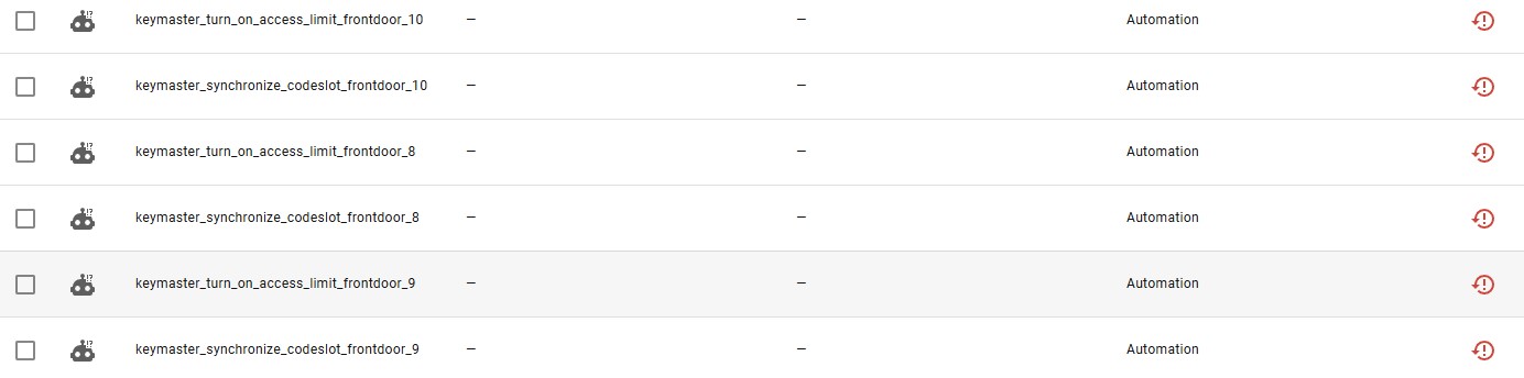

I happen to have 7 active Pins, and these look like automation for pins 8-10 which would obvs not be provided because I don’t use them.
Is it best practice to delete those too, or will that screw me up when I inevitably use the next few slots?
(in the absence of advice to the contrary, I’m just going to leave them. I’ve learned with HA and Zwave to suppress my OCD urges…)
Thanks again smarthome friends!
All of those automations can go away too. If it has keymaster in the name and is not associated with the integration then it’s from your prior installation as every entity is now properly associated with the keymaster integration.
The only ones you will want to keep around would be any automations and or scripts that you created that are for keymaster (such as notify scripts)
If it won’t go away, then the integration is providing it and it’s in an unusable state because of certain logic (for instance, the number of uses counter is not available unless the toggle for it is enabled)
