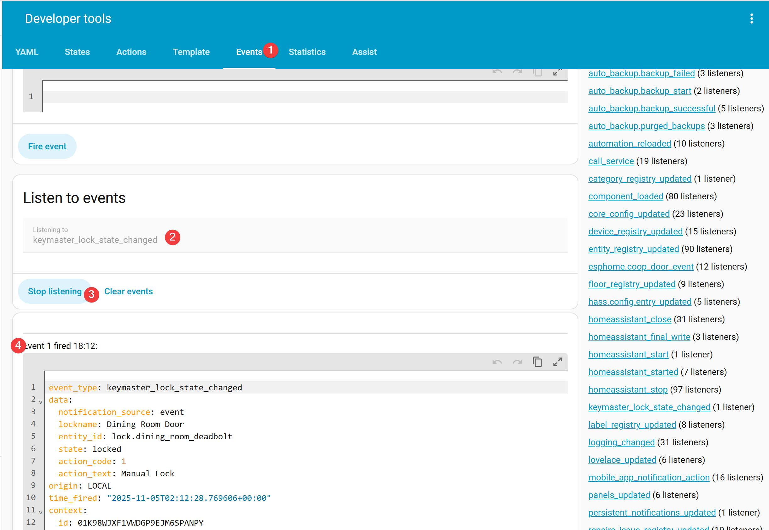

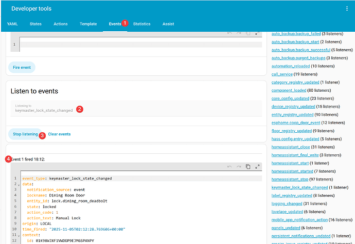

You’re close, but looking at the “states” page. You need to check the “events” tab. (1)
On the events tab, paste the event name that @brenthaag mentioned keymaster_lock_state_changed (2), hit “start listening” (3) and then trigger an event by opening a deadbolt or keying in a pin.
You should see the events showing up immediately below. (4)
Thank-you so much.
That worked a treat. I assume thats in a Wiki somewhere, apologies if I missed it but really appreciate your following up.
Anytime. :call_me_hand:t3:

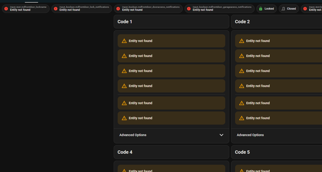

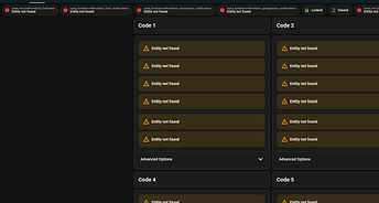

I had a few hours of power outage and most things recovered without a problem, including HA except Keymaster. Keymaster was working fine for years. Current version is v0.1.0.
All the Automations are gone, and am mostly getting errors “Entity not found” on the default Lovelace page.
I read up this thread and I do not know how to fix this.
If I go to Settings–>Integration–>keymaster–>Integration entries, under the lock all the details and options are still there.
What is my path forward? I saw someone uninstall and reinstall. Is that the only safe bet?
All of the input_foo type entities that you list on that page are from Keymaster before v0.1.x. The current dashboard files are generated in custom_components/keymaster/lovelace/<lock>.yaml and need to be added to a new dashboard.

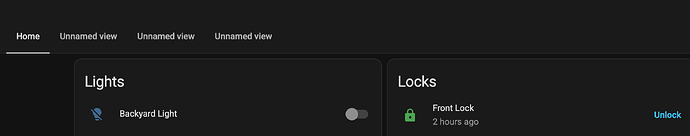

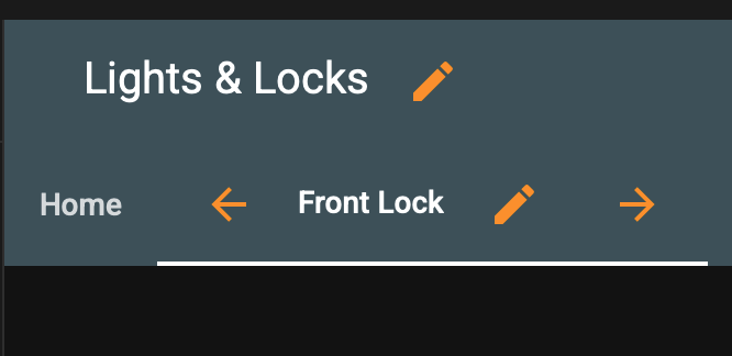

I’ve upgraded to the latest keymaster version and am trying to get the custom dashboard working. If I create a new dashboard, then it works great, but if I want tabs within a current dashboard, I’m unable to get the tab’s to be named anything other than “unnamed view”
This is the code I’m using in the raw config editor for the dashboard. I’ve also tried without a “title” tag
  - strategy:
      type: custom:keymaster
      lock_name: Front Lock
      title: Front Lock
      icon: mdi:door-closed-lock
  - strategy:
      lock_name: Garage Lock
      title: Garage Lock
  - strategy:
      lock_name: Side Lock
      title: Side Lock
Also, If I manually name it with the pencil icon, that negates the whole dashboard as expected.
