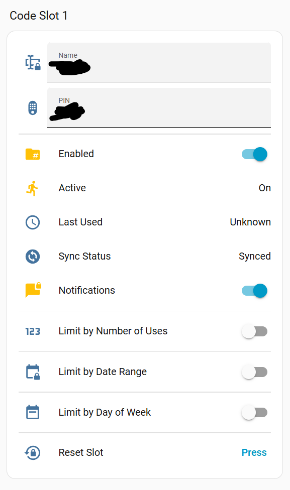

First issue: "Last Used doesn’t seem to be updating. I put a code into the slot, verified it physically worked on the lock, yet last used never updates.

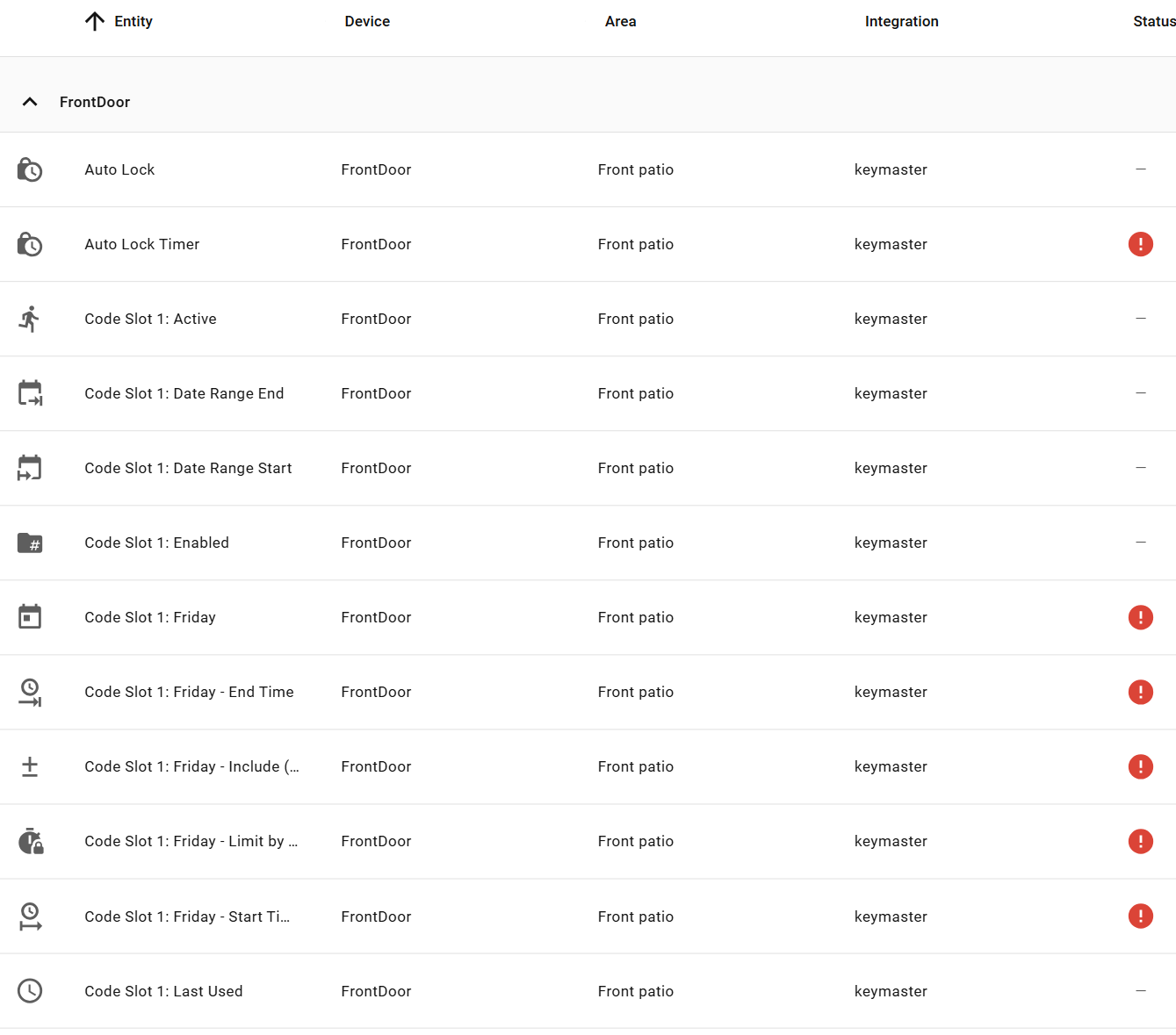

Second issue: Not sure if this is really an issue, I noticed the majority of the 500 entities KeyMaster created show as Unavailable. I’m assuming they are like this way until they are actually utilized?
What type of lock do you have? Last used should be working correctly for most ZWave locks and for Akuvox intercoms. If Keymaster is emitting an event on the code being used, it should update. If you’re using a Schlage WiFi lock it won’t work as the the underlying Schlage integration doesn’t know how to get usage events from the lock.
As for all of the Unavailable entities, you’re correct that they are in that state unless activated. If you don’t need all of the advanced features enabled (date range or custom day of week) then I recommend disabling the features entirely.

@JohnBeMe Can you setup notifications for the slot you’re trying this on and see if you get those? As long as those are working then the last used sensor should work as the code path is similar.

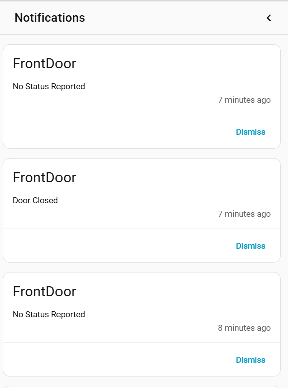

Now whenever I lock or unlock the door I get a persistent notification to the HA web page.
The only time there was an actual status sent is when the door was closed and the sperate door sensor I indicated in KeyMaster detected it.

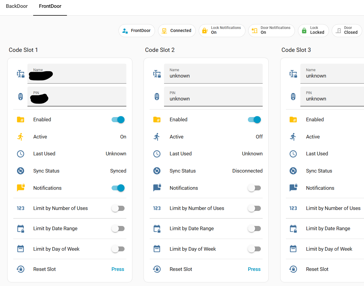

And as you can see, the Last Used status still does not update.
Let me if I can check for anything else, thanks!
If it’s a ZWave lock and you’re not getting unlock events (not door / open close events) then the last update sensor will not work. @firstof9 or @raman325 might have a way to determine if your lock is actually sending the correct events or not.

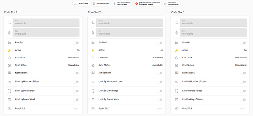

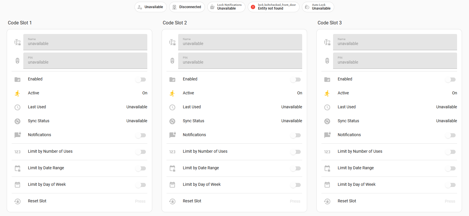

I have 3 BE469ZP locks, and when I use keymaster, I found 1 of the 3 generates its lovelace dashboard well with the strategy implementation, but 2 of the 3 partially generate but in a fairly/completely broken manner. In logs I find: Can't find the lock in the Entity Registry. But interestingly, they are healthy in zwave, I can ping them, the entities are enabled, etc.
Is there a process I can follow to try and diagnose? I've deleted and regenerated the dashboard multiple times with no success and compared all the equivalent entities exist/are healthy between the 1 working lock, and the 2 that are not. Same zwave firmware, etc. I just cant figure this out at the moment.
Thank you!
Update: I just went in and ripped the devices out of the integration, reconfigured, and now its a talking/living/breathing dashboard!
