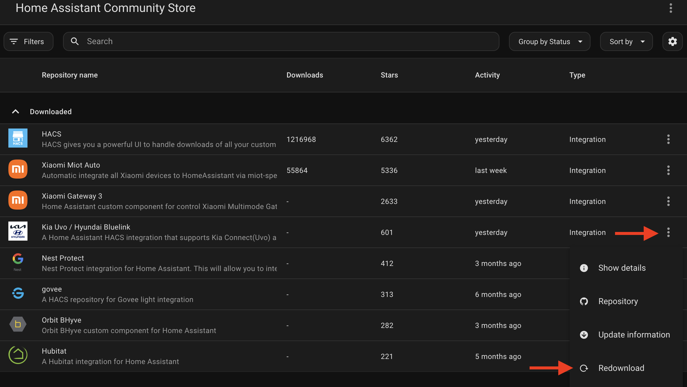

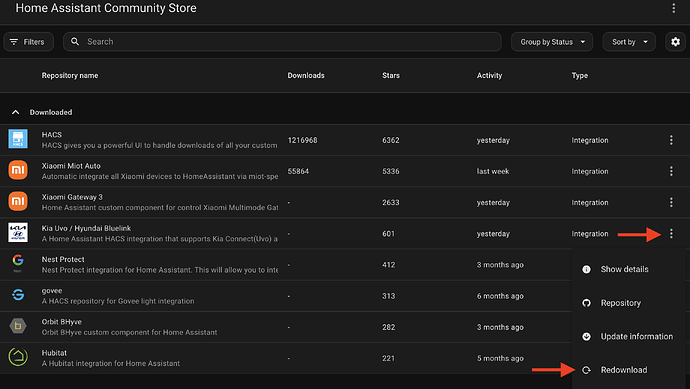

For Canadians with the Hyundai login issue, here’s what has worked for me:
If you have previously been messing around with files to try to get this working, I would suggest you first redownload the current version of the Kia Uvo / Hyundai Bluelink integratiion from HACS

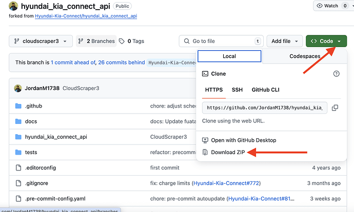

Expand the zip and just copy the folder hyundai_kia_connect_api (you don’t need the other files and directories for this fix) to the root of /config, it should not be placed in /config/custom_components where the kia_uvo directory is.

So did I. Does not seem to matter. I tried several itterations based on the comments posted on git and they led me to finally get it working by ignoring the instruction to rename the expanded zip directory and instead of just copy its sub-directory hyundai_kia_connect_api into /config.
The instruction to add “requirements”: [“./hyundai_kia_connect_api”], rather than just “requirements”: [“hyundai_kia_connect_api”] also resulted in error 500. Once I removed ./ and rebooted HA, it finally worked.
