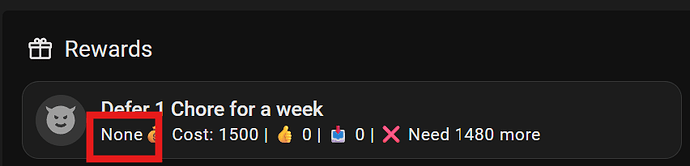

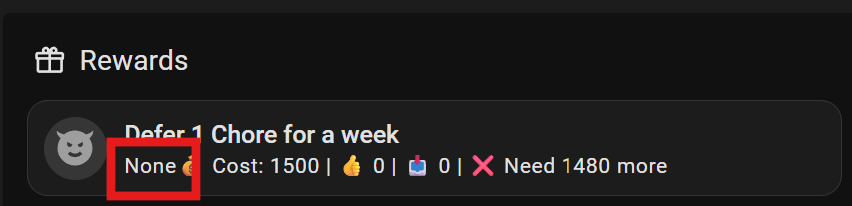

What I am trying to work out is how do I show the descriptions for the rewards and or the chores in their respective cards? Maybe a pointer on what to google or something I am completely lost right now.
EDIT:
So I found out that in creating the reward I could see the name of the text field as reward_description thus in the card I thought
{%- set reward_description = state_attr(sensor.entity_id, 'reward_description') | default('Unknown') -%}
      {#-- Add Reward Card to the list --#}
      {%- set ns.group_cards = ns.group_cards + [{
        'type': 'custom:mushroom-template-card',
        'primary': reward_name,
        'secondary': reward_description ~ "šŸ’° " ~ ns.COST ~ ": " ~ reward_cost|string ~ " | šŸ‘ " ~ approvals|string ~ " | šŸ“„ " ~ claims|string ~
but alas I get the following as the reward description despite there being descriptions loaded in the config menu.

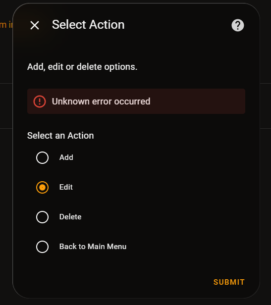

Unfortunately, today I went in to edit a chore and was presented with this error:
The following error is generated in the log
2025-07-21 09:37:35.848 ERROR (MainThread) [aiohttp.server] Error handling request from 127.0.0.1

  File "/config/custom_components/kidschores/options_flow.py", line 168, in async_step_manage_entity
    return await self.async_step_select_entity()
  File "/config/custom_components/kidschores/options_flow.py", line 203, in async_step_select_entity
    entity_names = [data["name"] for data in entity_dict.values()]
KeyError: 'name'
Connected
Any help would greatly be appreciated.
Is there a way to have a chore assigned to all kids, but first one who claims it gets credit and it gets removed from the rest for that week? For example I want to have ā€œTake out garbageā€ as a weekly chore but only 1 kid will get credit for that week. Once it’s grabbed, nobody else sees it due that week anymore.
I removed the integration, restarted HA, and reinstalled the integration.
I set up a test chore and was able to modify it.
Problem solved, I just have to start from scratch.
-Thanks.

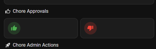

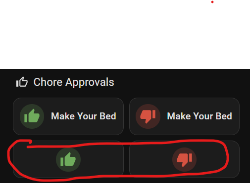

I have one chore approval showing blank that I can’t figure out how to get rid of. Nothing shows up in the HA log when I click either choice. I’ve tried resetting all that child’s overdue chores and didn’t help either.
How can I troubleshoot this?
Same problem here
