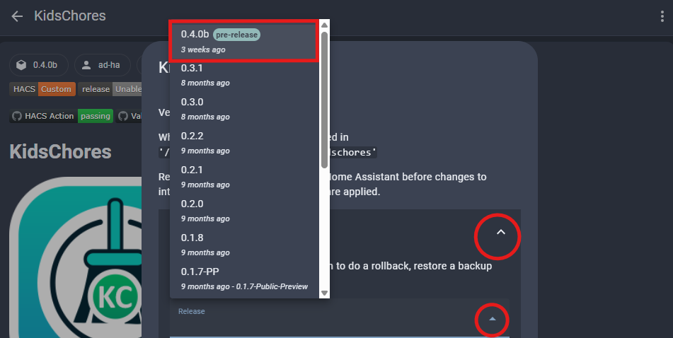

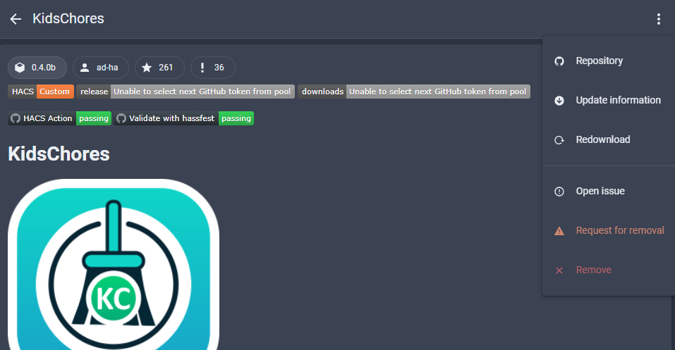

Sure. Let’s see if I can help.
Just go into the KidsChores on HACS, open the menu and select redownload:
Then click on ā€œNeed a different versionā€ and select the pre-release version:
And then ā€œDownloadā€.
Restart HA and it will be updated! :ok_hand:
