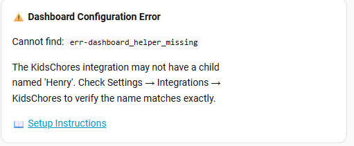

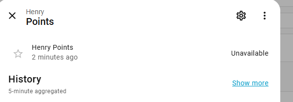

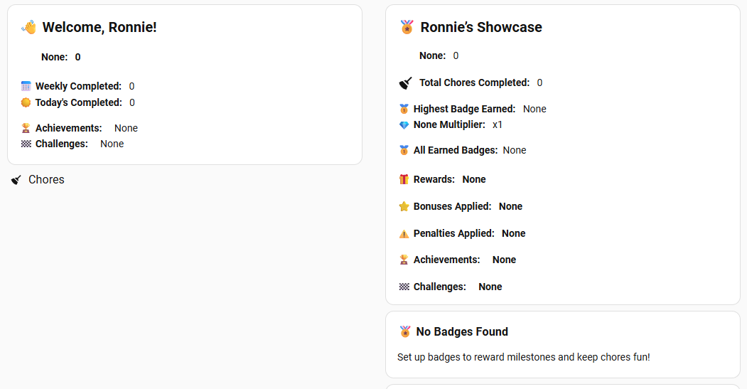

I’m having some trouble - the old-style dashboard doesn’t work (obviously, it has many dependancies on the old name schema), and when I try and create a new dashboard all of the entities go Unavailable. I’ve tried removing and re-adding the integration but the behaviour is the same. If I reload the integration all of the sensors for my kid come back, except for UI Dashboard Helper which remains Unavailable, and the dashboard shows err-dashboard_helper_missing
Edit: I’m also getting ā€œUnknown error occuredā€ if I try and edit Kids, Penalties or Chores. I don’t have any Challenges or Achivements so I haven’t tested those. I also seem to be missing various global sensors, I think.
Edit 2: So, it also looks like all entites belonging to the integration go Unavailable every five minutes, on the dot. I thought it was an old ā€œUpdate KidsChore UI Helpersā€ automation, so I turned it off, but it’s still happening! And I just now realised that obviously that’s the case, because the automation goes off every five minutes, not ā€œevery five minutes after I restart the integrationā€. I’d love to be able to help troubleshoot this, but I don’t know where to start :slight_smile:

However, I’m in the same boat as many, in that the dashboards (both previous format and the new auto-created) are broken. The previous one just has no data pulling through, the new one just shows lots of ā€˜Dashboard config error’ boxes, cannot find ā€˜err-dashboard_helper_missing’.

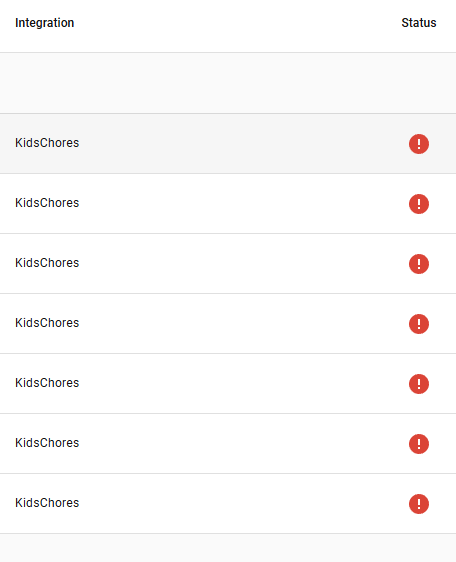

All entities show as ā€˜Unavailable’, although do show available, with data, for a short time after reloading the kidschores integration. It seems to bounce between having a value, and being unavailable.
Lots of errors in the log.

The dashboards are just a layer on top of the integration, so it’s hard to tell much from those. First thing to do would be to go into the integration and see if the devices and entities are showing correctly. Then in developer tools to look for entities that are unavailable or have errors. There are a lot of good steps in the wiki to help get started. Troubleshooting: KidsChores Troubleshooting Guide Ā· ad-ha/kidschores-ha Wiki Ā· GitHub
My best guess is that the something in the config is not fully unloading which was one of the biggest issues with how the old versions stored data. Be sure to restart once you remove the integration, then after a restart, and before adding the integration back look for those entities to see if they are still stuck. If so, do a diagnostic download from the integration after adding it back and restarting again and post the diagnostic file to the GitHub Ā· Where software is built.

Thanks for the pointers - I can confirm that deleting the integration again, but restarting prior to re-adding it, is now resulting in all devices and entities showing correctly, and available.
With some quick testing on the previous ā€˜manual’ dashboard, I was able to pull through data, but this requires updating of all the naming conventions for the entities.
Hoping the new dashboard would work, but that is still showing the errors as before.
edit - 5 minutes after posting this, they are all back to unavailable again

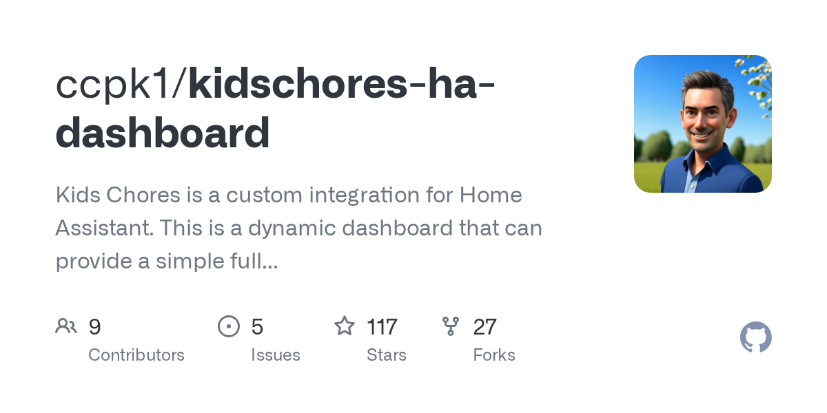

I’m new to KidsChores. I have setup the integration and want to setup the dashboard. However, it appears the dashboard repository no longer exists. The links on this page (Advanced: Dashboard Ā· ad-ha/kidschores-ha Wiki Ā· GitHub) all redirect to the wiki (Home Ā· ad-ha/kidschores-ha Wiki Ā· GitHub). Does anyone have the updated link?
I fixed the links in the wiki, looks like there was a small typo in the address causing issues.
