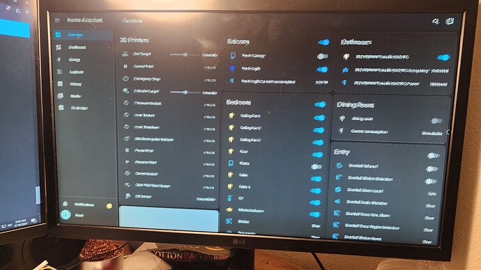

Ok I am really getting frustrated with this. After spending WAYYYY too much time trying to get this to work (i mean at least a couple dozen hours wasted on something that according to the documentation should be as easy as running a damn script) I FINALLY at least got it to load… Except… It looks like this.
I mean, what the actual FCK am I doing wrong now? Not only does it not display properly, I can’t kill it from SSH with systemctl --user stop touchkio.service except for the first time. Once I restart it, the command does nothing and I have to reboot because I cant find any other way to kill it locally - and then it comes up garbled again, I can kill it once from SSH, then never again. No side panel either, and I can move the cursor (it is currently hooked up to my monitor at my desk with a keyboard and mouse) but clicking anywhere does nothing.
In an effort to get Labwc working I installed Trixie RC1, installed Labwc, and fell on my face yet again. Could not get it to work. Reinstalled again. Used Plasma 6. It says it’s running in Wayland mode. That’s where I finally got this damn thing to actually install and run. But now I have this. Oh, and why is it loading the “Overview” instead of the dashboard? I put in the URL of the dashboard I want (http://10.9.10.40:8123/dashboard-dashboard/0), and it brings up the overview (http://10.9.10.40:8123/lovelace/0). ??? ??? ???
