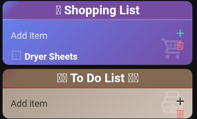

Hi @leukipp, thanks for this great app! It works quite nicely.
A really trivial thing I came across that I was wondering how to solve. To enhance the WAF I put little emojis into text items on my dashboard. Here’s an example; on my laptop and phone they look fine but on the touchkio they show up as unknown objects. The top image is from my PC and the bottom is from touchkio. The little emojis are in the title, I copy/paste from Emojipedia. Anything I should look at? Thanks!
You are probably missing a font. Is you laptop/pc a Windows device? If so, it has an emoji font integrated. Same for mobile.
You could try with https://fonts.google.com/noto/specimen/Noto+Color+Emoji but as I do not use emojis, this is just an idea rather than a tested solution.
It’s running on an RPi5 with the Rasp OS. I’ll poke around to see if I can load emoji fonts on it. Thanks.

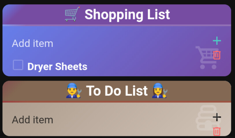

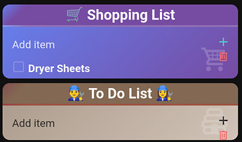

In case someone else lands here with the same issue, I found the solution; at least it worked for me :slight_smile: My situation did not require the ‘exports’ but I left them there in case it could help someone else.
If emoji icons are not displaying correctly in terminal output (Or browser), install the Noto Color Emoji font:
sudo apt-get update
sudo apt-get install fonts-noto-color-emoji
fc-cache -f -v
After installation, restart your terminal or log out and back in (reboot is also a good option).
If emojis still don’t display, ensure your locale supports UTF-8:
export LANG=en_US.UTF-8
export LC_ALL=en_US.UTF-8
