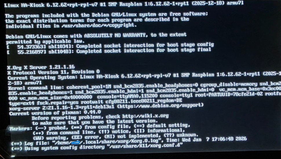

When booting the system, a lot happens until there is only a black screen at the end.
There are no entries in Xorg.0.log.
The attached image shows the last screen before it goes dark …
Any Idea wht to do?
The black screen will be the default openbox desktop and it would appear the chromium hasn’t started. If you attach a mouse and keyboard to your pi/kiosk you should be able to right click on the desktop.
It’s been some time since I used openbox but I think the right click menu would give you an option to open a terminal. Do that and try the chromium command string you have in your autostart file. That should show if the command is correct for your system
