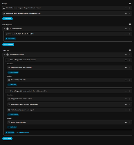

Not sure what I wrote earlier confusing.
My idea is that when I walk into the kitchen. Light auto on. Walk into the toilet and the toilet presence sensor will trigger the toilet light to be on.
When the toilet presence sensor detect human around, the kitchen light will remain on.
When the toilet presence sensor detect no human and there is no motion in kitchen sensor, the kitchen light will turn off. I am having issues making sure the automation run a full cycle.
I think you need to break it down into more simple options and add some more triggers.
Option 1 - kitchen motion detected = kitchen light on
Option 2 - kitchen presence clear for x minutes = kitchen light off
Option 3 - toilet motion detected = toilet light on
Option 4 - toilet presence clear for x minutes = toilet light off
For Option 2, add a second condition for ‘toilet presence clear for x minutes’.
Change the mode to ‘single’.

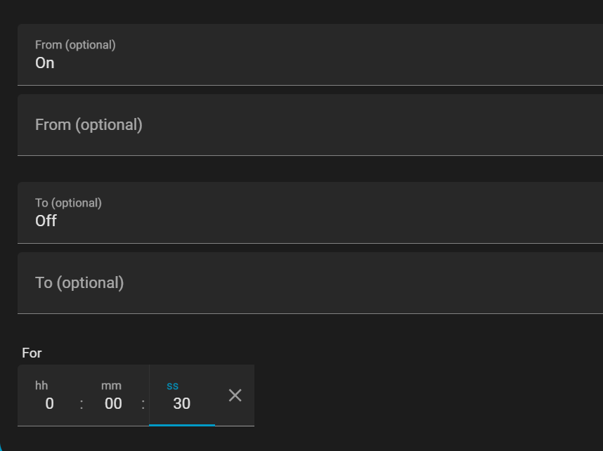

  • Open up your automation and look at the top triggers part.
  • Your second trigger states: When Kitchen Sensor Occupancy changes from Detected OR Clear. Click on that.
  • Delete the “off” in that part. It’s in the wrong section (from instead of to)
  • In the TO section, select off, then set the 30s timeout there.

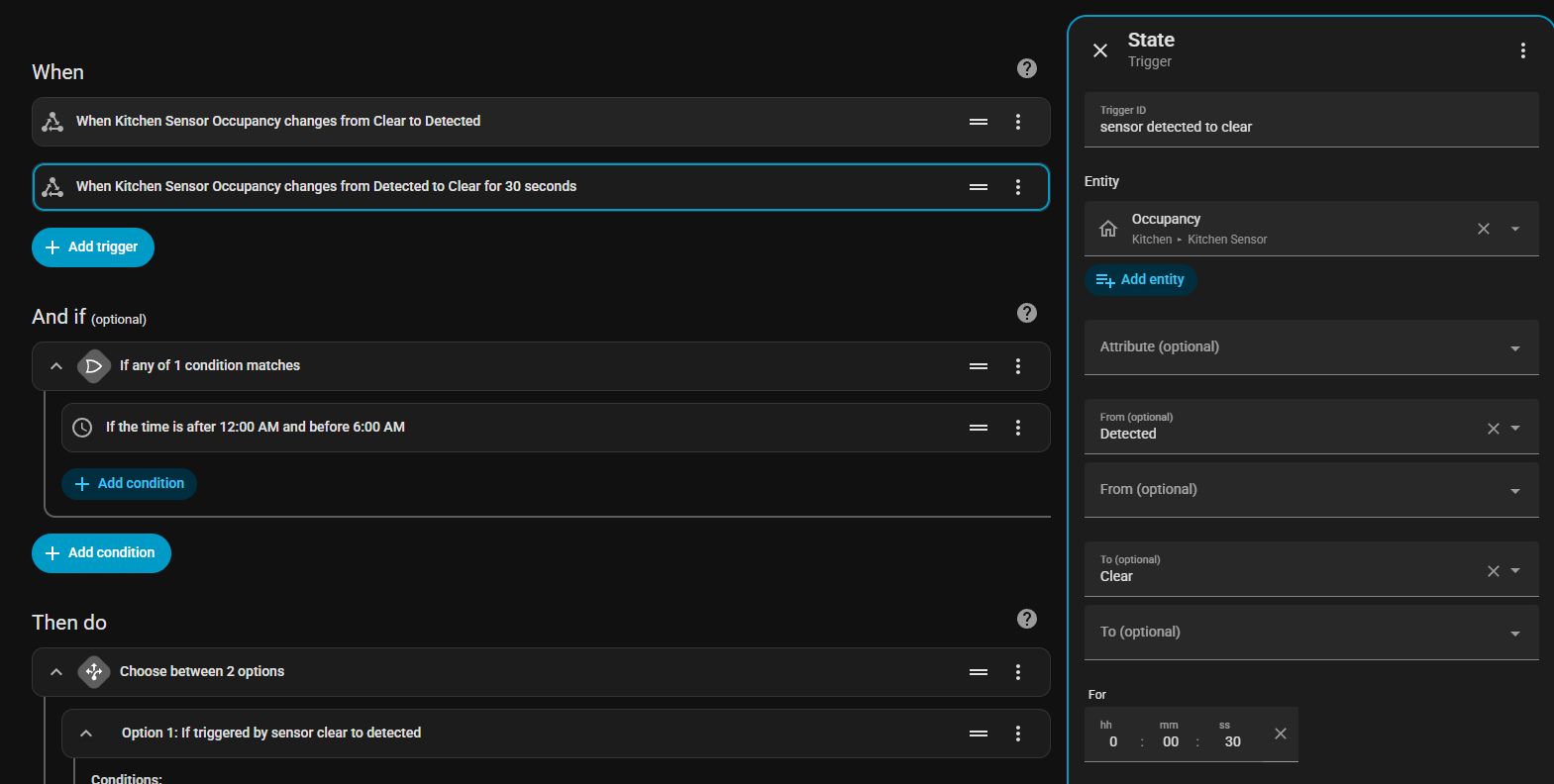

    You should be looking at something like this:
okay okay thank you very much
I would think this is correct?
It is indeed. Congrats on learning something new :slight_smile:
thank you so much but can i ask is the 30 sec act as a cooldown and also for a human to have a action inbetween so it will only re trigger the whole automation if it goes clear and for 30 sec?
Indeed it is.
Your previous automation was triggering immediately when it went from detected to clear. It was then checking the conditions that it was clear for 30s.
That is not how conditions work in HA. Once a trigger fires, a condition is evaluated immediately, so your condition was never met (because your sensor had only been clear for less than 1s at the time) and your automation stopped there.
