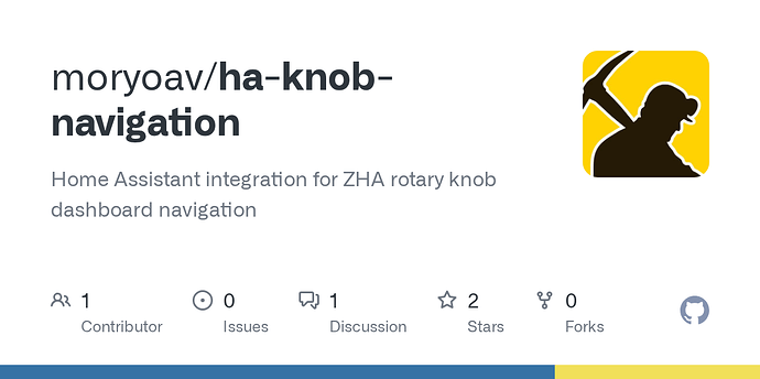

Repository:
More detailed information and examples:
It currently supports ZHA knobs that emit zha_event with command: rotate_type, where rotate_type: 0 is next and rotate_type: 1 is previous. Setup is through Settings -> Devices & services after installing the integration, so there is no dashboard YAML/template helper/shell command setup needed.
