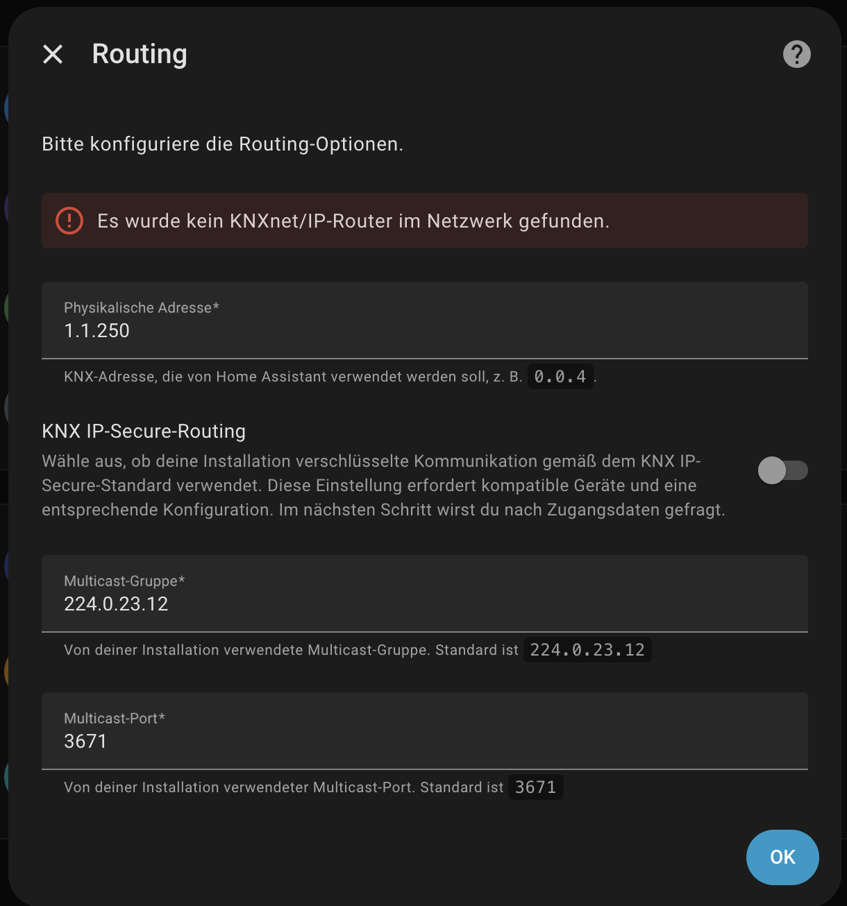

My KNX add-on shows no errors, but the connection still doesn’t work. The entities I created with group addresses (GA) do not respond. In the Home Assistant KNX monitor I can see that telegrams are being sent, but in the ETS monitor – on the bus side – they never arrive.
So I tried to reconfigure the add-on and ran into the issue mentioned in the subject: In tunneling Routing mode, I don’t see any field where I can enter the IP address of my KNX router (see picture).

Going of the screenshot you do not have a Router but an Interface (tunnel) in your setup.
So setting it up as a router will not work.

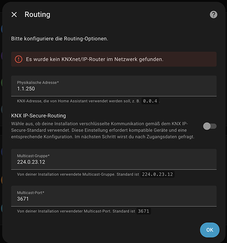

But this windows is that i get, when i click on Configuration → routing
That is a router yes. But if you want to use tunneling you need to select tunneling in the page you showed in the last screenshot.

You will be able to set the IP address when you select tunneling.
Did you try that? Also if you use tunneling you need to pick a KNX address that is provided by the router. They should show up under the router itself in ETS.
The fact that you get the message that no router cold be found may suggest a network problem.
