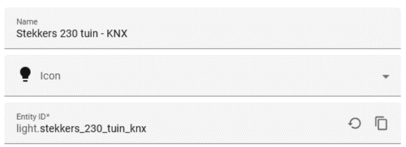

A very long time ago, I entered all my KNX addresses in the configuration.yaml file, together with a certain name. At that time, there was no other way. And everything worked fine.
Later on, we could change the name and the entity-id in a visual interface. What I certainly did. And perhaps I have forgotten to do the same in the configuration.yalm file
But now, certain KNX entities don’t work anymore.

Take this example of an entry in the configuration.yaml file. The name is ‘Stekkers 230 tuin 8 KNX’
    - name: 'Stekkers 230 tuin 8 KNX'
      address: '0/0/8'                  #1bit Switch N512
      state_address: '0/0/8'
In the graphical user interface of the KNX integration, I cannot find this name ‘Stekkers 230 tuin 8 KNX’
In reality this switch corresponds still with an old name “stekkers_230V_tuin_knx”
So the KNX integration is NOT using the name from the configuration.yaml file. But from ??
The KNX integration probably uses the KNX address as a reference. Because, when I put the adress in comment → the “old name” is shown as unavailable.
