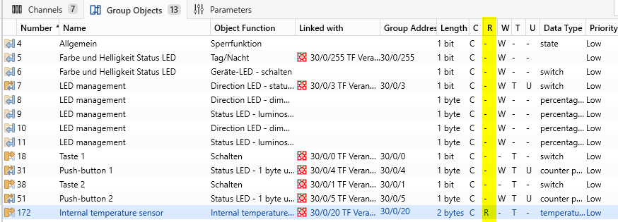

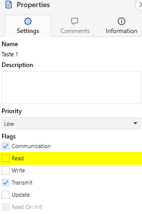

Now, as example, there’s a wall pushbutton and an integrated temperature sensor. The temperature sensor is the only object, where the Read Flag is set and never shows up in the log as timed out. The pushbuttons itself have not set the Read flag and do show up in the logs as timed out.
Do you suggest me to check the Read flag on the pushbuttons? I’ve never unchecked that flag, so I wonder a little bit. But I see you wrote usually, so I assume defaults are not always set correctly by the manufacturer.
So grateful for your support, thanks!
No. You shouldn’t read a state from something that triggers an event. If a button turns on a channel of a dimming actuator, read the actuators state, not the buttons.
I’d recommend to change to group address view. In a single GA you should have at most 1 object with the read flag set.
If there is none, this address can’t be read. Which is fine for some addresses - like relative dimming etc. (stateless event triggers). In HA you shouldn’t configure those as *_state_address` though.

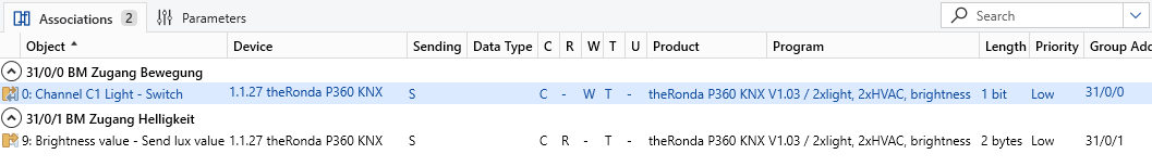

Okay. I still try to figure out the problem, say, on a motion detector. Taken out one of my configuration, as example.
It has two Group Addresses,
  • motion (“Bewegung”) with a Write but no Read flag
  • brightness (“Helligkeit”), with a Read but no Write flag
Brightness is configured as sensor according to the docs as follows:
- name: "BM Zugang Helligkeit"
  state_address: "31/0/1"
  type: "illuminance"
This address is not showing up in the logs as timed out. According to your explanation, because the Read flag in ETS is set.
Motion is configured as binary sensor according to the docs as follows:
- name: "BM Zugang Bewegung"
  state_address: "31/0/0"
  device_class: "motion"
This address is showing up in the logs as timed out, as it has no Read flag set in ETS.
May I ask, what screw would you turn?
Depends on how the motion sensor works. If it reports 1 when motion and 0 after some time, I’d probably set the read-flag… and test it reporting correct values when read :wink:
When it only ever sends 1, I’d not use a BinarySensor, but a telegram trigger.
Or use sync_state: False for this entity. See KNX integration documentation. But you’d have no initial value when restarting HA then (or restored value, not sure now).
I’ve added sync_state: false to all wall pushbuttons (they send true and false when pushed and released) and motion detectors (they send true and false when motion detection is triggered and untriggered). All log entries are gone now and I’m sure thigs will work great in the near future.
