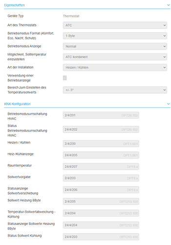

Here is my knx configuration:
d24bddfcbe74c44331040cabd94e2d655aba3e4e_2_690x355

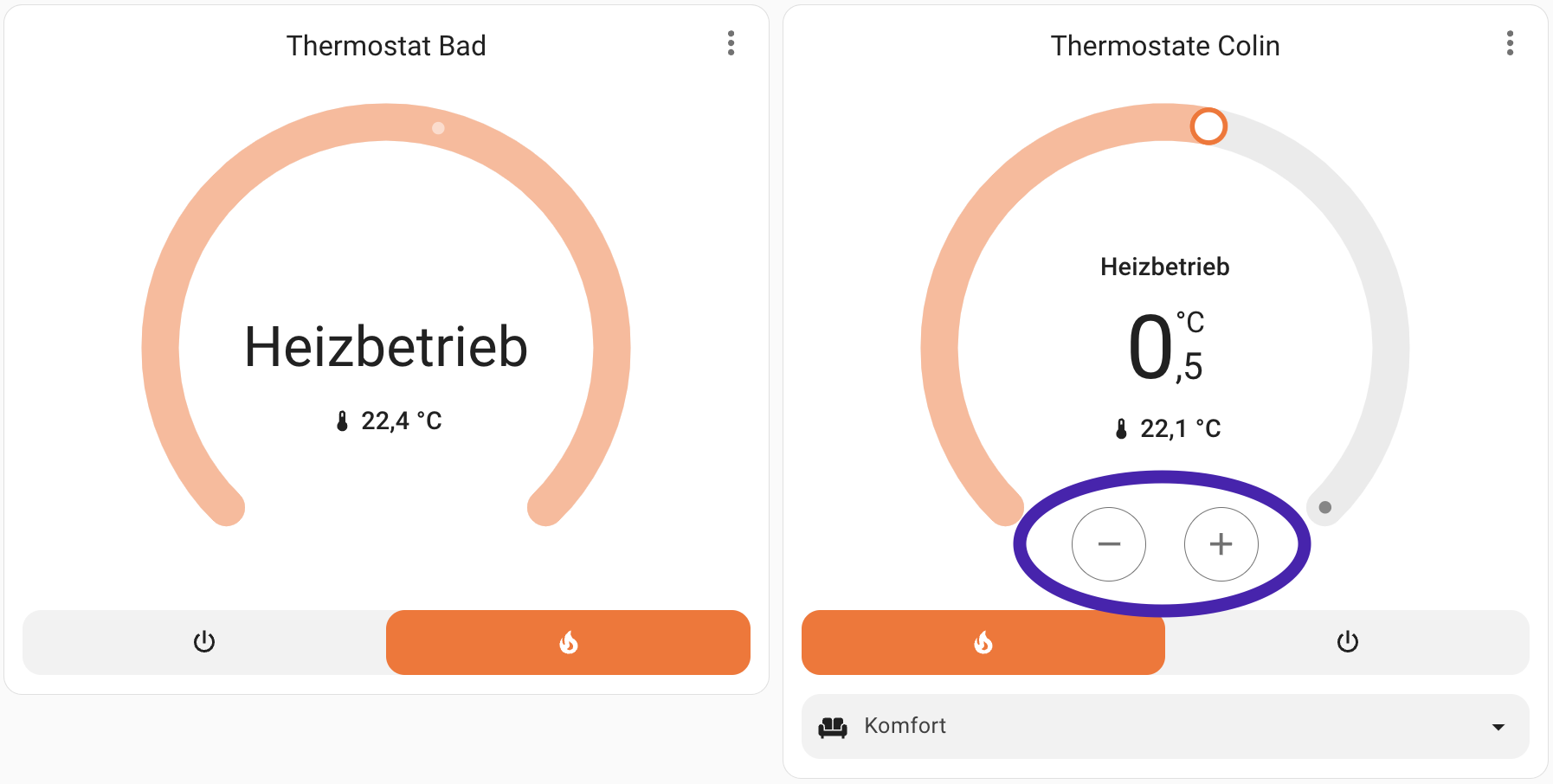

here the difference between my app and home assistant
b40291202463ddf62356a250b2b6d06cb3a72938_2_254x499
Screenshot 2023-09-29 124121
It sets the shiftpoint to the configured mode. In that case 21° so shiftpoint 1,0 which is 22°.
Is it possible to show the target temperate (in that case 22°) or do I need to create help entitiys to calculate the target temperature?
I think “Sollwert Heizung 8Byte” Could be the one. Unfortunately it shows NULL.
e48a7fb06686ca8014e9f3f1dbf0c630d2e3b7d4_2_350x500
Does anybody have an idea on how to get the target temperature as shown in the domovea app?
Shouldnt it be the Solwert Vorgabe? so that would be group address 2/4/203
You could read out 2/4/204 and see what value that gives, but looking at the climate card it looks like thats a binary GA
Both doesn’t work. I don’t get it. It should be possible to figure out the Target temperate. At the end it is just the configured temperature of the mode (in this case “Komfort”) plus the configured setpoint.

I am asking because I am trying the same as you. My goal is to move from the Hager Domovea app to Home Assistant.
I even notice a strange behavior. If I change temperature values in the Domovea App, the + and - symbols are appearing in Home Assistant. After a restart the symbols are gone.
I could find the issue :blush:
It was caused due to a missing flag for allowing to “read”.
