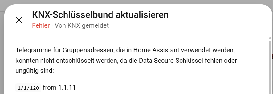

Clicking on the error message I get "Telegrams sent to group addresses used in Home Assistant could not be decrypted because the Data Secure keys are missing or invalid:" together with a long list of group addresses. None of those group addresses are on the main line. And I found that all of the group addresses on the list had the security setting "off" - I now changed them to "automatic" - but still the same I updated the keys - no effect. And, by the way, none of the devices mentioned in the list in HomeAssistant supports data secure.

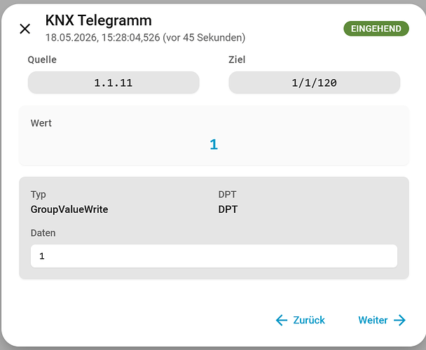

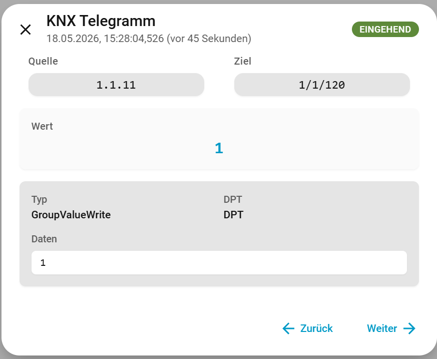

This is one of the Telegrams HomeAssistant listed in the list
And is there another telegram, a DataSecure one, for the same GA too?
No. Only non-secure ones appear in the monitor - but at the same time the non-secure one appeared in the monitor it also appeared in the error list.
