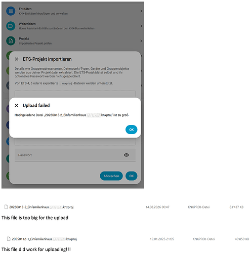

I tried to upload my newest ETS6 configuration file to Home Assistant and got the following upload error (see attached file).
With smaller file size it worked out fine, but a lot of group addresses are missing now.
I couldn’t find any way in ETS6 to reduce the size of the .knxproj file.
Could anyone help?
