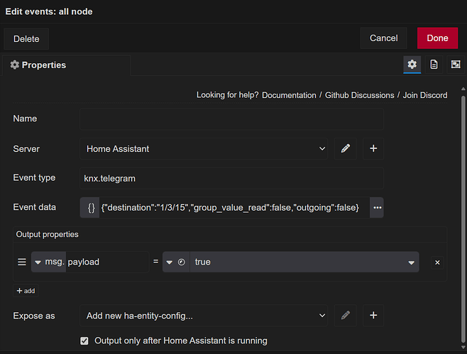

This is the configuration I use on Node Red:
but I can’t receive anything.

I don’t know Nodered, but knx.telegram is a trigger, not an event… I guess this doesn’t work here.
There is knx_event - maybe this is what you are looking for. See knx integration documentation for how to set it up.
Try using knx_event for the event type with no event data. Connect it to a debug node set to complete message object.
I also tried knx_event, but I still can’t get it to work. Maybe I’m using the wrong “event data” code? I tried both “destination” and “address”
Anyway, I can’t get knx_event to work in Home Assistant automation either.

Leave the event data blank for now. Only use event type. Event data has to be exact. Knx_event will let all knx events through.
Once you find the event you are looking for, we can narrow it down to that 1 event type.
This is the solution!
First add the event to the yaml configuration, then configure nodered with knx_event.
