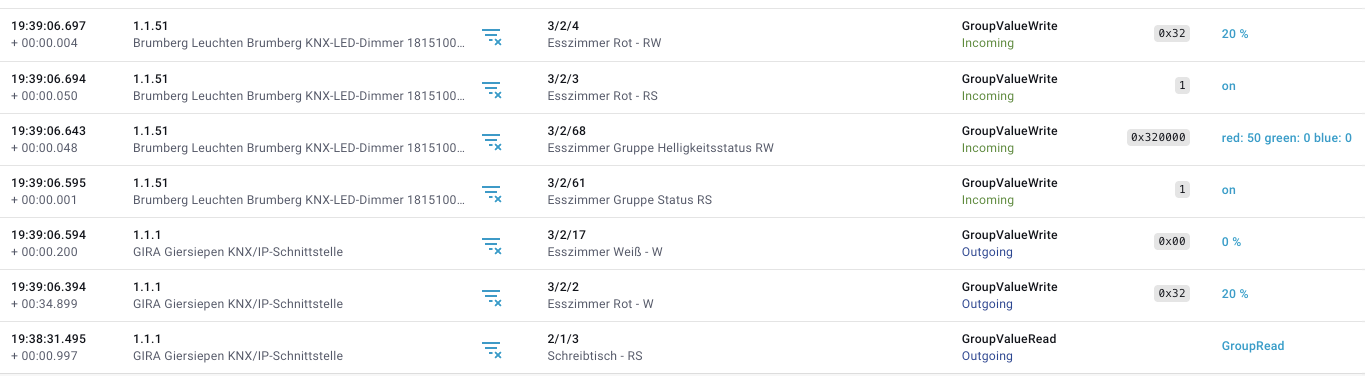

my KNX RGBW control is acting recently very strange. It used to work all find and I would not be aware of any change that I had done that could have any impact on the controlls.
Basically when I turn on the RGBW lights I can not control the color. not that it does not act at all but is mostly stays on white, sometimes changes to other colors, mostly sticks to white or other light colors.
Secondly it is not only controlling the light that is adressed by the entity but also another RGB light!.

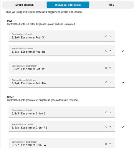

I checked the KNX entity settings and they are completely correct.
When I see the KNX monitor log I see what I observe when I try to change the lights: there are KNX telegrams going out mainly on white, sometimes on the other colors, and also to the second RGBW.
I’m really lost!
Any ideas where to look?
Thanks!

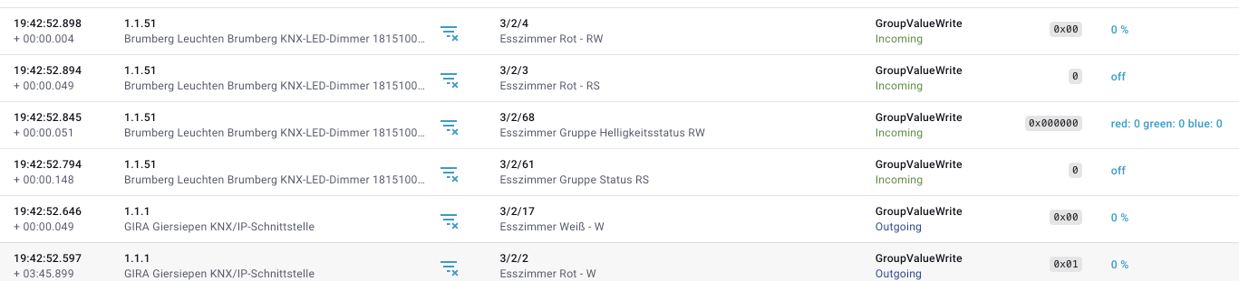

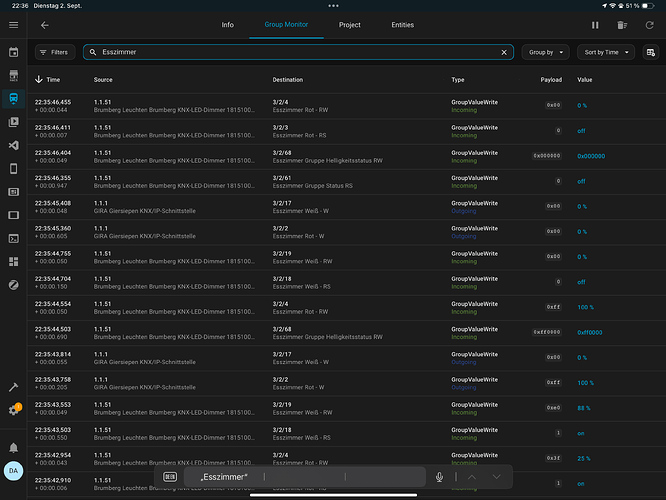

Attached a screenshot of the KNX group monitor. This was taken while I was changing colors. As you can see it has mainly sent out telegrams to white, no matter what color I selected. The result on the RGB strip was a shift between white at several brightness levels and red.
Obviously HA does not correctly generate the KNX telegrams.
Just to test, I created a light just on a single RGB color and then it works.
How can this be?

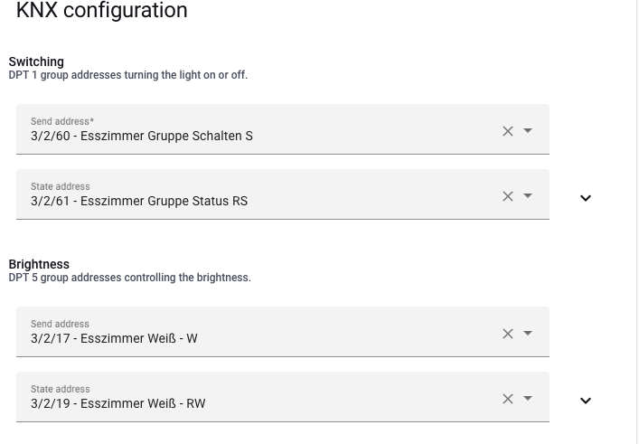

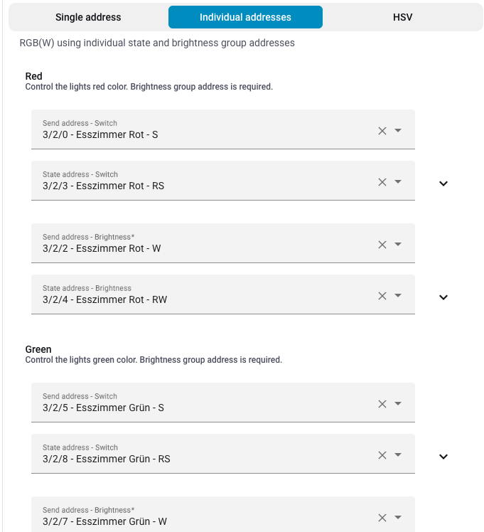

I’m also attaching the KNX setup screenshots.

I would not have expected it any differently because from what I see HA is just not generating the right KNX telegrams. Like when I change the color to red there should be a KNX telegram going out that sets red to 255 but this is just not happening. Hence this appears to be rather an issue of HA than the link to KNX.

Also, fix the configuration (remove “brightness”, add the addresses to “white” instead if it is only white brightness) and have a look at the group monitor again then.

in a correct individual addresses configuration, it should send 3-4 telegrams. One for each color.

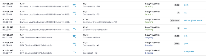

Have a look at the log report attached.
Starting Point is the RGB being off.
I clicked on a pure green to get the RGB started.
What goes out to KNX is however: Set red to 20%, White 0%.
This is then what the controller executes and confirms.
Next I changed it to a bright blue:
again what you see is that is sets white and red values to 0%. Which is probably right. What is missing is HA triggering green.

Found the issue. Thanks for reporting :+1:
Should be fixed - hopefully in 2025.9.2 - by
