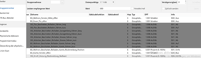

I have covers that I control via KNX and the KNX integration. Control via Dashboards work great. I now want to integrate the cover-position into scenes (Good Night, Good Morning). Unfortunately the KNX integration sends a “Run Short” AND a “Run Long” to the covers, so they do not find the right position. They just interpret the run-short command.
Any ideas or workarounds?
