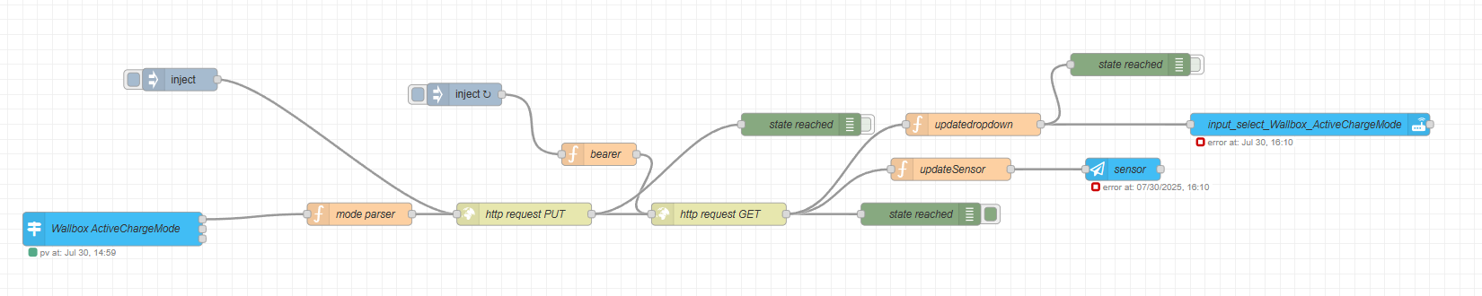

No need to answer bc thats just details. But would it be possible to show the correct active charging mode (for example lock) also in the dropdown menu for the ā€œwallbox_active charge modeā€. Right now the status could be ā€œLockā€ (if chosen via kostal app). The sensor would also show ā€œLockā€ then but the dropdown menu for choosing the charging mode would not change.

[{"id":"1c2c32c88581c620","type":"inject","z":"cf9db411ca071c46","name":"","props":[],"repeat":"5","crontab":"","once":false,"onceDelay":0.1,"topic":"","x":550,"y":920,"wires":[["63c0a7846f0d9def"]]},{"id":"63c0a7846f0d9def","type":"function","z":"cf9db411ca071c46","name":"bearer","func":"var msg1 = { payload: { \"mode\": 0, \"bearer\":0 } }\nmsg1.bearer = global.get(\"Kostal_bearer\") ;\nreturn msg1;","outputs":1,"timeout":"","noerr":0,"initialize":"","finalize":"","libs":[],"x":730,"y":940,"wires":[["73ce9212b81f3379"]]},{"id":"73ce9212b81f3379","type":"http request","z":"cf9db411ca071c46","name":"http request GET","method":"GET","ret":"obj","paytoqs":"ignore","url":"http://192.168.178.161/api/e-mobility/config/chargemode","tls":"","persist":false,"proxy":"","insecureHTTPParser":false,"authType":"","senderr":false,"headers":[{"keyType":"other","keyValue":"Authorization","valueType":"msg","valueValue":"bearer"}],"x":890,"y":1020,"wires":[["af4da4c66b94f9c8","d922837769ba1bcc","9b7f04539fb8c74b"]]},{"id":"3da08757f403f1f9","type":"http request","z":"cf9db411ca071c46","name":"http request PUT","method":"PUT","ret":"obj","paytoqs":"ignore","url":"http://192.168.178.161/api/e-mobility/config/chargemode","tls":"","persist":false,"proxy":"","insecureHTTPParser":false,"authType":"","senderr":false,"headers":[{"keyType":"other","keyValue":"Authorization","valueType":"msg","valueValue":"bearer"}],"x":630,"y":1020,"wires":[["73ce9212b81f3379","9f8bb0b07fae6721"]]},{"id":"af4da4c66b94f9c8","type":"debug","z":"cf9db411ca071c46","name":"state reached","active":true,"tosidebar":true,"console":false,"tostatus":false,"complete":"true","targetType":"full","statusVal":"","statusType":"auto","x":1160,"y":1020,"wires":[]},{"id":"d922837769ba1bcc","type":"function","z":"cf9db411ca071c46","name":"updateSensor","func":"var msg1={};\n\nmsg1.entity_id = `sensor.Wallbox_CurrentActiveChargeMode`;\n\nmsg1.payload = {\n    data: {\n        state: msg.payload.mode,\n        attributes: {\n            'name': 'Wallbox_CurrentActiveChargeMode',\n            friendly_name: 'Wallbox_CurrentActiveChargeMode',\n            icon: 'mdi:pulse'\n        }\n    }\n};\n\nreturn msg1;\n\n","outputs":1,"timeout":"","noerr":0,"initialize":"","finalize":"","libs":[],"x":1200,"y":960,"wires":[["25ef1c9c74581477"]]},{"id":"9b7f04539fb8c74b","type":"function","z":"cf9db411ca071c46","name":"updatedropdown","func":"var msg1={};\n\n\n\nmsg1.payload = {\n    \"option\": msg.payload.mode\n};\n\n\n// msg.payload = {\n//     domain: \"light\",\n//     service: \"turn_off\",\n//     data: {\n//         entity_id: [grupo],\n//     }\n// };\n\nreturn msg1;\n\n","outputs":1,"timeout":"","noerr":0,"initialize":"","finalize":"","libs":[],"x":1230,"y":900,"wires":[["337d69047b0532b5","f9607479d9b41f71"]]},{"id":"3882f4f45550bff1","type":"inject","z":"cf9db411ca071c46","name":"","props":[{"p":"payload"}],"repeat":"","crontab":"","once":false,"onceDelay":0.1,"topic":"","payload":"{\"mode\":\"grid\", \"mincharginpowerquota\": 0, \"minpvpowerquota\": 100}","payloadType":"json","x":190,"y":900,"wires":[["3da08757f403f1f9"]]},{"id":"a7046d486f71bf95","type":"function","z":"cf9db411ca071c46","name":"mode parser","func":"var msg1 = { payload: { \"mode\": 0, \"bearer\":0 } }\nvar SelectedMode = msg.payload\nvar mode\nif (SelectedMode === \"lock\") {\n    mode = '{ \"mode\": \"lock\", \"mincharginpowerquota\": 0, \"minpvpowerquota\": 100 }';\n}\nelse if (SelectedMode === \"grid\") {\n    mode ='{ \"mode\": \"grid\", \"mincharginpowerquota\": 0, \"minpvpowerquota\": 100 }';\n}\nelse if (SelectedMode === \"pv\") {\n    mode = '{ \"mode\": \"pv\", \"mincharginpowerquota\": 0, \"minpvpowerquota\": 100 }';\n\n}\nelse if (SelectedMode === \"hybrid\") {\n    mode = '{ \"mode\": \"hybrid\", \"mincharginpowerquota\": 0, \"minpvpowerquota\": 100 }';\n\n}\n\nmsg1.payload = mode;\nmsg1.bearer = global.get(\"Kostal_bearer\") ;\nreturn msg1;","outputs":1,"timeout":"","noerr":0,"initialize":"","finalize":"","libs":[],"x":410,"y":1020,"wires":[["3da08757f403f1f9"]]},{"id":"9f8bb0b07fae6721","type":"debug","z":"cf9db411ca071c46","name":"state reached","active":false,"tosidebar":true,"console":false,"tostatus":false,"complete":"true","targetType":"full","statusVal":"","statusType":"auto","x":1000,"y":900,"wires":[]},{"id":"25ef1c9c74581477","type":"ha-api","z":"cf9db411ca071c46","name":"sensor","server":"541ade28.b4a62","version":1,"debugenabled":false,"protocol":"http","method":"post","path":"/api/states/{{entity_id}}","data":"","dataType":"json","responseType":"json","outputProperties":[{"property":"payload","propertyType":"msg","value":"","valueType":"results"}],"x":1430,"y":960,"wires":[[]]},{"id":"337d69047b0532b5","type":"api-call-service","z":"cf9db411ca071c46","name":"input_select_Wallbox_ActiveChargeMode","server":"ba0f7c7d.deae9","version":7,"debugenabled":false,"action":"input_select.select_option","floorId":[],"areaId":[],"deviceId":[],"entityId":["input_select.wallbox_activechargemode"],"labelId":[],"data":"{\"option\":$join(payload.option,\",\")}","dataType":"jsonata","mergeContext":"","mustacheAltTags":false,"outputProperties":[],"queue":"none","blockInputOverrides":true,"domain":"input_select","service":"select_option","x":1560,"y":900,"wires":[[]]},{"id":"f9607479d9b41f71","type":"debug","z":"cf9db411ca071c46","name":"state reached","active":false,"tosidebar":true,"console":false,"tostatus":false,"complete":"true","targetType":"full","statusVal":"","statusType":"auto","x":1453.0435791015625,"y":828.0435180664062,"wires":[]},{"id":"6f5f9d3707cc17c5","type":"trigger-state","z":"cf9db411ca071c46","name":"Wallbox ActiveChargeMode","server":"ba0f7c7d.deae9","version":5,"inputs":0,"outputs":3,"exposeAsEntityConfig":"","entities":{"entity":["input_select.wallbox_activechargemode"],"substring":[],"regex":[]},"debugEnabled":false,"constraints":[],"customOutputs":[{"messageType":"default","messageValue":"","messageValueType":"json","comparatorPropertyType":"always","comparatorPropertyValue":"","comparatorType":"is","comparatorValue":"","comparatorValueDataType":"str"}],"outputInitially":false,"stateType":"str","enableInput":false,"exposeToHomeAssistant":false,"haConfig":[{"property":"name","value":""},{"property":"icon","value":""}],"x":140,"y":1020,"wires":[["a7046d486f71bf95"],[],[]]},{"id":"541ade28.b4a62","type":"server","name":"Home Assistant","version":5,"addon":true,"rejectUnauthorizedCerts":true,"ha_boolean":"","connectionDelay":false,"cacheJson":false,"heartbeat":false,"heartbeatInterval":"","areaSelector":"friendlyName","deviceSelector":"friendlyName","entitySelector":"friendlyName","statusSeparator":"at: ","statusYear":"numeric","statusMonth":"2-digit","statusDay":"2-digit","statusHourCycle":"h23","statusTimeFormat":"h:m","enableGlobalContextStore":true},{"id":"ba0f7c7d.deae9","type":"server","name":"Home Assistant","version":5,"addon":true,"rejectUnauthorizedCerts":true,"ha_boolean":"y|yes|true|on|home|open","connectionDelay":false,"cacheJson":true,"heartbeat":false,"heartbeatInterval":"30","areaSelector":"friendlyName","deviceSelector":"friendlyName","entitySelector":"friendlyName","statusSeparator":"at: ","statusYear":"hidden","statusMonth":"short","statusDay":"numeric","statusHourCycle":"h23","statusTimeFormat":"h:m","enableGlobalContextStore":true}]
If ok, you can think about not using the sensor anymore!

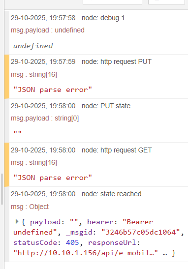

Hello! Really beautifully implemented project and it works without problems so far! Unfortunately, except for one small issue and I hope to find a solution here…
Unfortunately, I get an error message ā€œJSON parse errorā€ with every HTTP request Get Node - does anyone have a solution for this? Actually, I’m only interested in the MinChargingPowerQuota and MinPVPowerQuota values read back from the API…
Thanks in advance! Leon
Could you share your code?

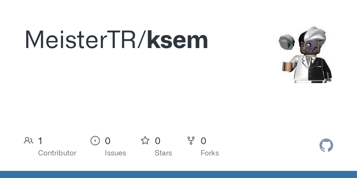

hello, i searched for controlling my enector for over 2 Years. Now i decided to make my own integration. Please test and report!

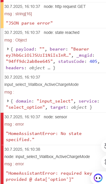

Hey Buddy. It worked like a charm for months now I get an error out of the suddon.
The Sensor doesnt seem to work anymore.
Maybe you can help? Would be much much appreciated!
Kostal changed the api, the state is now only avaiable over a websocket connection with push option. I tried a few days to get it running in node red but it dont work. So i decided to get it running with a ne component…

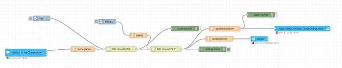

Any idea on how to change the red note above?
Worked lovely until now…
Or better use your ingegration? How stable is it?
Thx :))
I tried different websocket nodes without luck. The itegration works pretty good.
Works like a charm! Much much appreiciated. Thank you!
