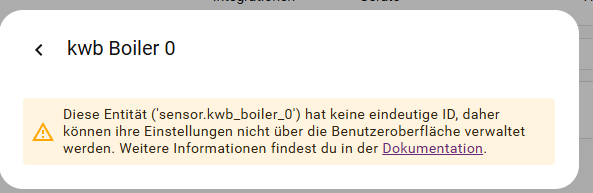

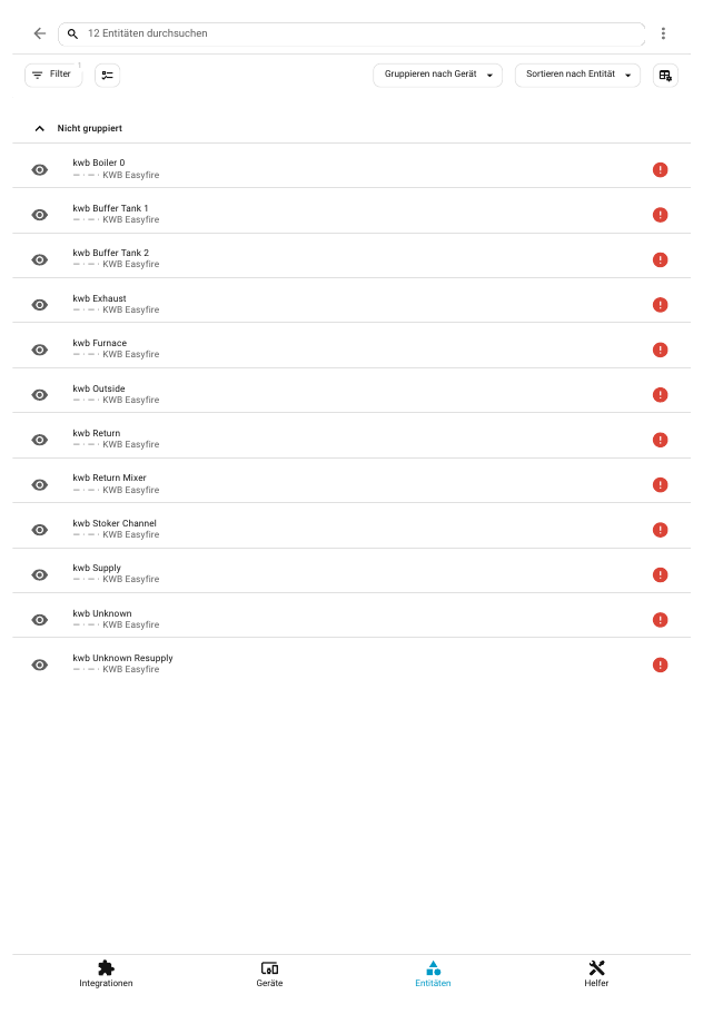

I would like to integrate my KWB Easyfire2 with Comfort 3 and a network card for comfort-online into HomeAssistant.
Since ComfortOnline unfortunately keeps crashing, I would like to map my KWK Easyfire2 to HomeAssistant.
In Comfort3, I selected ‘Webinterface’ under Grundeinstellungen/Hardware, and under software is Copmfortonline and Intercom enabled. For Intercom, I entered the IP address configured for the Easyfire2 in my Fritzbox.
I have now entered the following in the configuration.yaml:
  • platform: kwb
    host: 192.168.0.174
    port: 502
    type: tcp
    raw: False
Unfortunately, I only get the following displayed in HomeAssistant:
I have already tried ports 22 and 23 without success.
Can someone please help me.

Hey Guys,
i have the same problem. I connected my easyfire from 2008 with comfort 3.
i used a usr-dr302 to connect the easyfire to my lan.
but i still get this screen
thats my whole yaml:
Loads default set of integrations. Do not remove.
default_config:
Load frontend themes from the themes folder
frontend:
themes: !include_dir_merge_named themes
automation: !include automations.yaml
script: !include scripts.yaml
scene: !include scenes.yaml
Example configuration.yaml entry
sensor:
  • platform: kwb
    host: 192.168.178.189
    port: 23
    type: tcp
    raw: false
Im very new into homeassistant, so i dont know how to get the data of my heater.
the next problem ist, that my english ist not rather good - sorry
Perhaps someone can help me?
