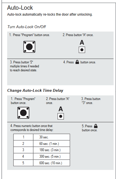

I just bought the 620 LR model and am having issues with some of the options not working like auto lock.
You have to configure autolock from the keypad.
