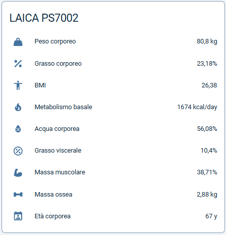

Supported measurements
With a complete barefoot measurement, the integration exposes:
  • Body weight
  • BMI
  • Body fat
  • Body water
  • Muscle mass
  • Bone mass
  • Visceral fat
  • Basal metabolic rate
  • Body age
  • Impedance
Impedance is exposed as a diagnostic entity.
Body age is available but disabled by default.
If the scale cannot perform bioimpedance analysis — for example when weighing while wearing slippers or shoes — the integration can still detect the stable weight measurement and updates only the body weight, without overwriting or recalculating the previous body-composition values.

Screenshot
