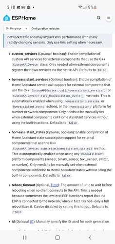

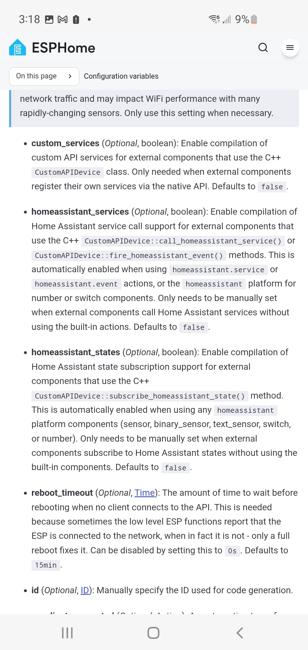

I’d avoid using HomeassistantActionRequest directly as its not a public API and isn’t stable between version.
Use custom_api_device.h instead
Ya, well your friend “AI” will really screw you up and ultimately just make things more difficult for you if you never bother trying to actually learn how to do thsse already supported actions like this. There is a whole section in the official Esphome documentation that covers API/Service calls/Events and provides lots of detailed explanations and examples so that it’s easier to understand. Using service calls is already a supported festure and therfore shouldn’t require you to use any custom code like your “friend” gave you. This is why i say that using AI will ultimately cause you more trouble than its worth. Just read the documentation.
bdraco & Jimmy
I can’t say that is very well documented.
Where do you find documentations about this? The native API page has mentions of it at best but no proper explanations or examples
You probably aren’t looking or trying hard enough because using AI is always essier and faster for people but, in the long run this method will pay far more dividends!

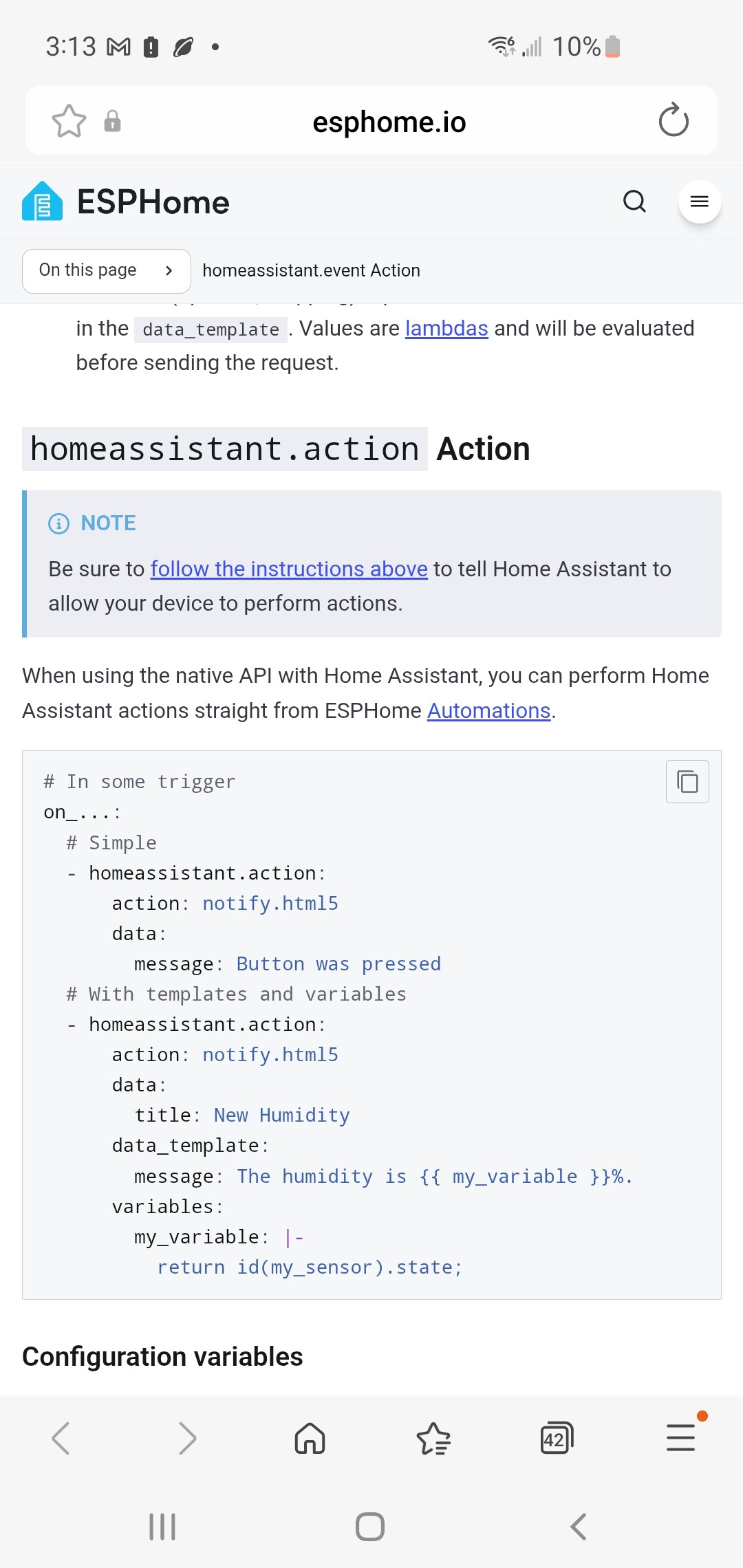

Service
Keep in mind that there are both options for “event” and “action/service” that could be used.
See, its all there.
This is not lambda.
I know it can be done without lambda but that isn’t the main goal.
It would complicate things if i was not using lambda.
And the second post is at best a mention, not a documentation.
Ya, no kidding! Lambda is for whenever you need to write custom code for something that isnt supported already by the current Esphome syntax. All of what you are trying to do is already supported and can very easily be setup without needing to make any of it through lambdas.
It’s fine one minute and the next minute its causing hissy fits… For such small things your doing and trying to send some homeassistant.actions based on the state of a rotary encoder, you’re really making this way more complicated and difficult than it ever needed to be and that it is. If you elaborated more on what it is you’re trying to do then maybe people could steer you in the best direction for example, I am nealy certain that whatever it is you’re trying to do here you dont even need to be messing with homeassistant.action or homeassistant.service etc. There are very specific scenarios where you might need to use those and for practically everything else there are far better ways to accomplish the same thing.
Well then! What exactly isn’t mentioned in it and is something you need? They give you a list of all the different api actions along with every single one of those actions configuration options that can be used so… unless you recently learned some cheat codes that enable hidden features then at best you’re just overlookeding details or at worse, you dont fully understand how the documentation is organized and how to use it correctly but, in all honesty everyone has that problem starting out and even myself struggled at first with it untill i figured it out and then things started falling into place with little difficulty afterwards.
