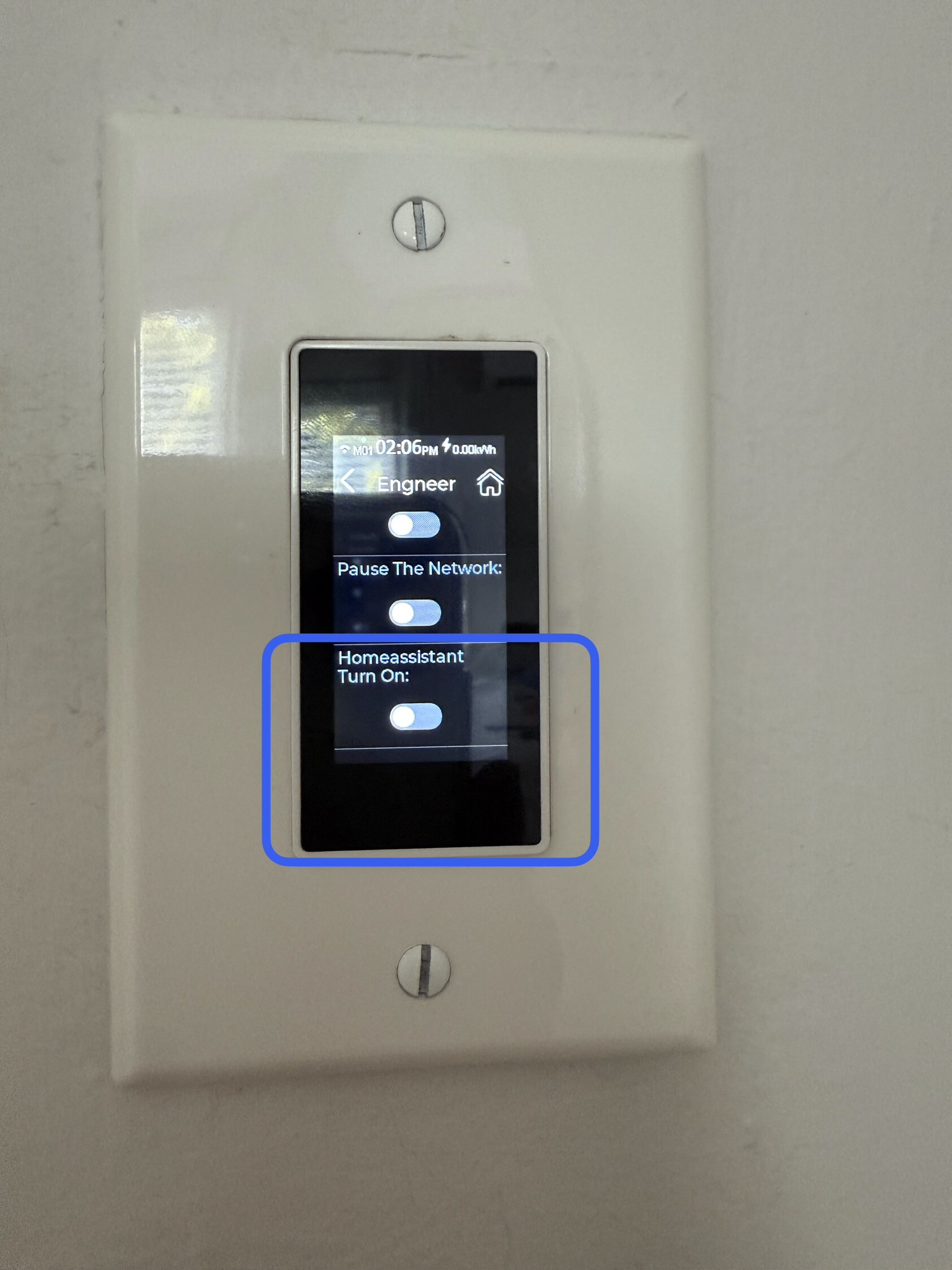

interesting part. I started digging through the menus on the switch via the lcd touch screen. I did find this option under menu, settings, engineering, ‘homeassistant turn on’ . So of course I enabled it, LOL :rofl:. But alas nothing happened on HA side. Even restarted HA again & the switch just to be extra safe.
Maybe it’s for a future firmware where HA integration maybe possible. Not sure.
