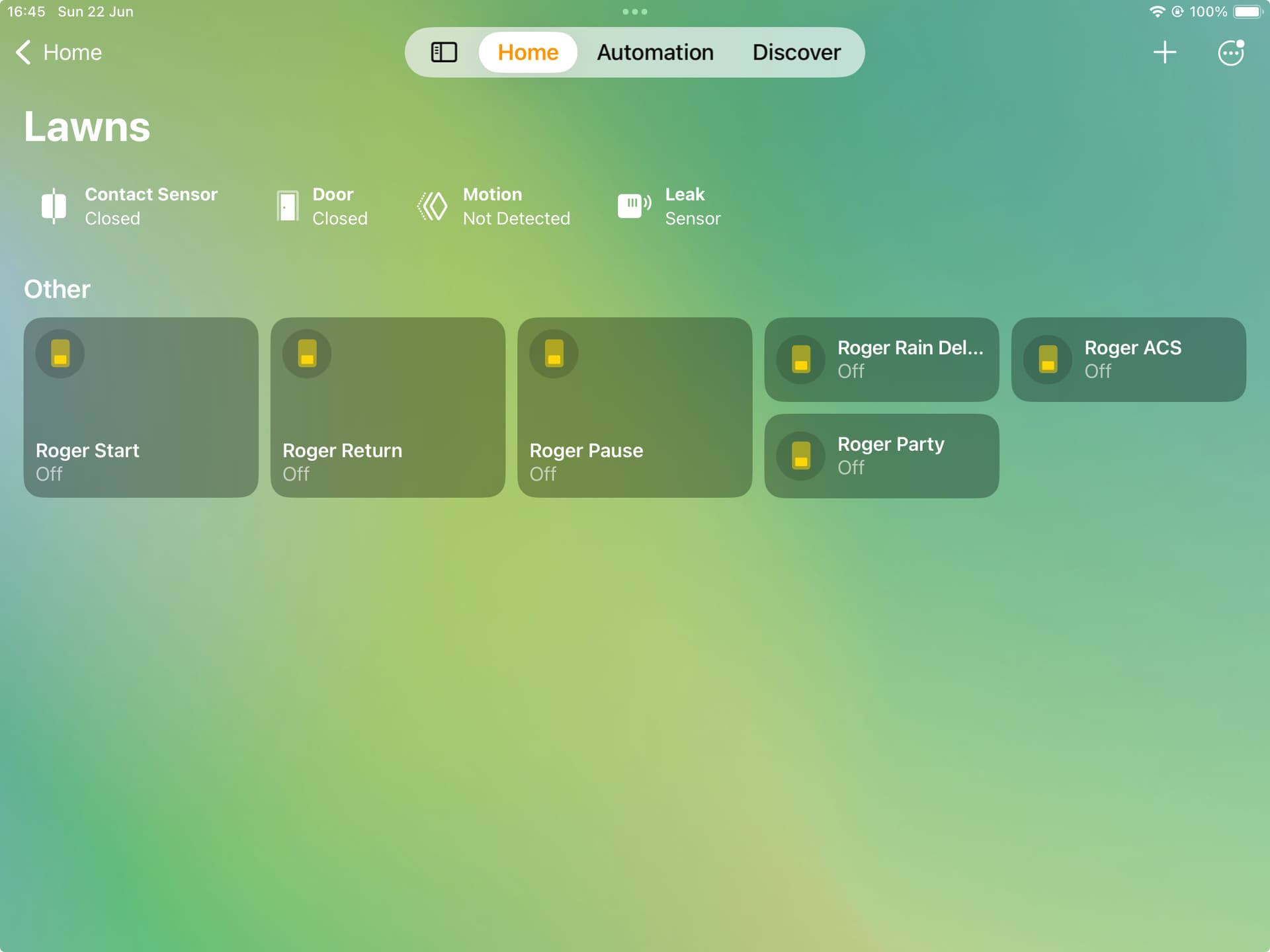

These scripts can be added to your configuration.yaml file. It will set up a range of switches that should all be exposed to Apple Home via a single HomeKit bridge that you can add to your Apple Home. These include:
  • A HomeKit bridge for Landroid
  • A ‘garage door’ sensor to indicate if the Landroid is docked
  • A ‘motion’ sensor to indicate if the Landroid is returning to dock
  • A ‘moisture’ sensor to indicate that the Landroid has detected rain
  • A ‘contact’ sensor to indicate that the Landroid is in error
  • A ‘contact’ sensor to indicate that the Landroid is in low battery (I have set it to <10%)
  • An on/off switch that can be used to start mowing/pause (on = start mowing, off = pause)
  • An on/off switch to return the robot to the dock (on = return, off = pause)
  • A ‘sticky’ on/off switch that pauses the robot (on = pause, off = does nothing - this allows you to choose to start mowing or return with the other switches)
  • An on/off switch for rain delay (on = delay 60 mins [can be configured], off = no rain delay)
  • An on/off switch to enable ‘party mode’ (on = party mode, off = party mode disabled)
  • An on/off switch for the Anti-Collision System
When configured, it should look like this:
